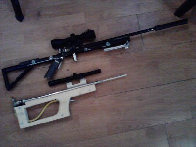

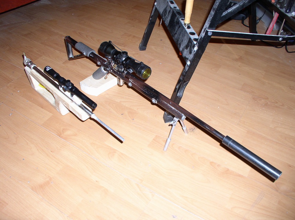

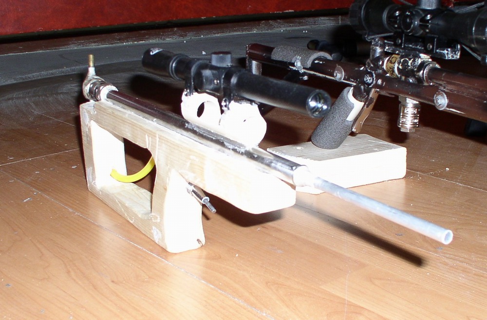

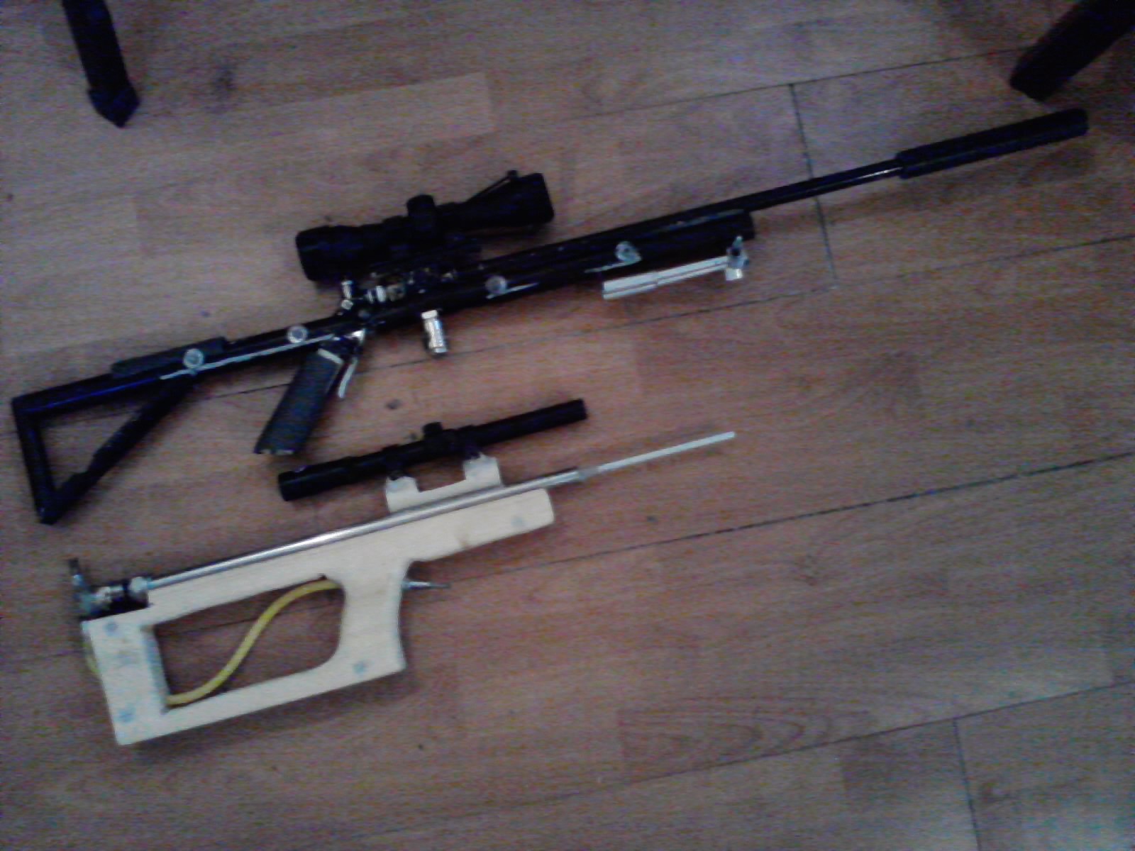

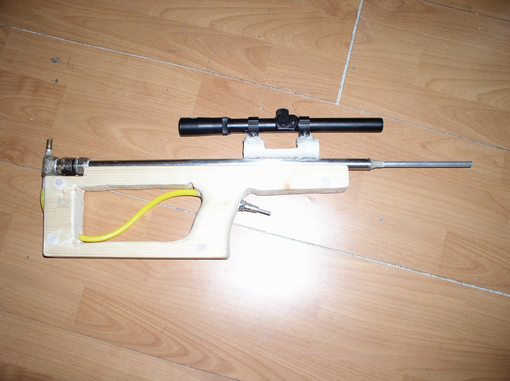

This is my new air gun, and a first try to make a wood stock :P .As i was trying to make it small, i choused a coax design. The trigger is homemade, not as good as a blowgun, so i made a high sensitive diaphragm. The gun works pretty well, max pressure is about 200 psi because the diaphragm :oops: .
comparing to my old sniper, only 1/2 size :)

Wow that little one looks like a Aug. Walnut would look good on that one... Nice work, they both look good.
Cute, could have been made more efficient and shame you can't up the pressure further but nice compact little plinker, hope you're going to make an integral suppressor to complete the look :)

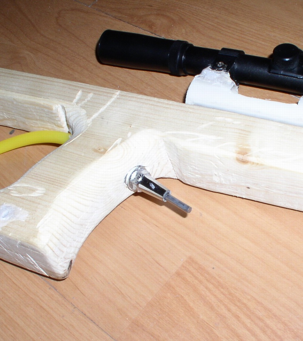

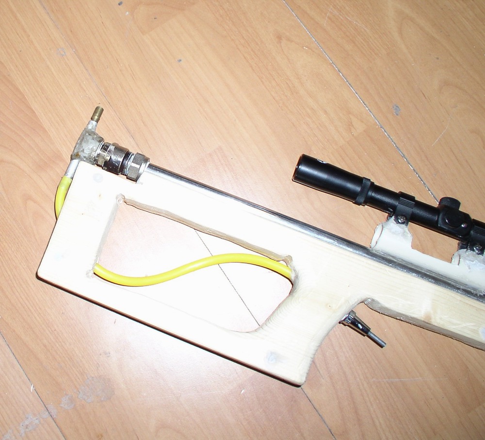

your pilot valve seems interesting, yet the pictures aren't clear enough to see it very well, any details or better images of that?

As i said, HD pics coming soon probably tomorrow, but the pilot valve isn't anything special. JSR i said the diaphragm can't takes much pressure, it's made of 2 layers of tire with 1 metal disc and all glued together with super glue, i really don't think it takes more than 200 psi and can't found another way to make a high sensitive piston/diaphragm :(. But btw i do have a plan for a nice metal supressor :)

nice job especially for a first time! what is your piston?

urgle the danish cow wrote:nice job especially for a first time! what is your piston?
there is no piston :D as i said i use a diaphragm made os layers of tire :(
