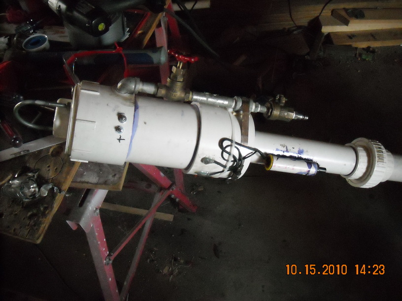

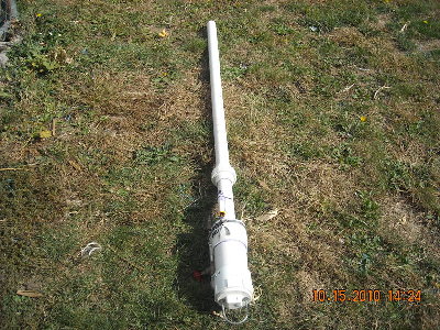

Camber 4x10"
barrel 2"x5'.
meter pipe 3/8" running direct tank pressure.

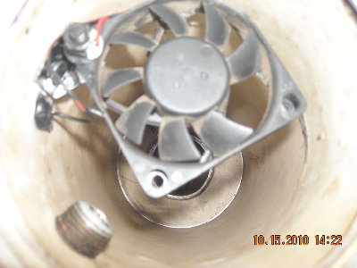

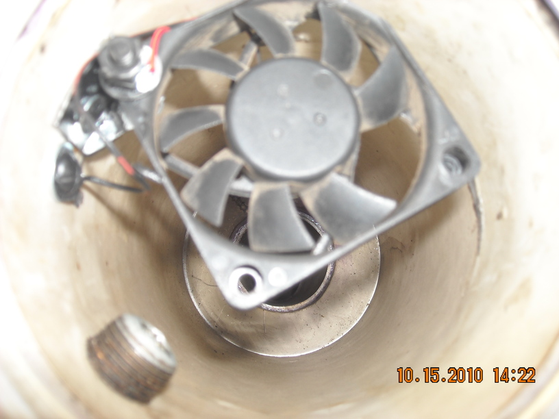

This show the + and - hookup for the fan, i use a benchtop powers supply at home and a battery pack from a drill modified to hold 2 nine volts and a switch, it has 2 leads with aligator clip and i zip tie the pack to the cannon<br /><br />It alo shows the BBQ ignitor held in 3/4&amp;quot;pvc conected 2 drywall screw for a single spark gap. the electrical connectin were soldered and coverd with silicone
It alo shows the BBQ ignitor held in 3/4&quot;pvc conected 2 drywall screw for a single spark gap. the electrical connectin were soldered and coverd with silicone
The blade was broken by actdentally reaching in while the fan was running.

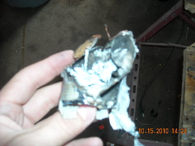

shot a D cell out of this cannon with a sabot and this i what i got

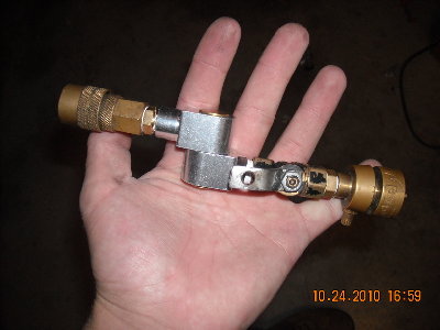

Quick connect propane fuel adapter
