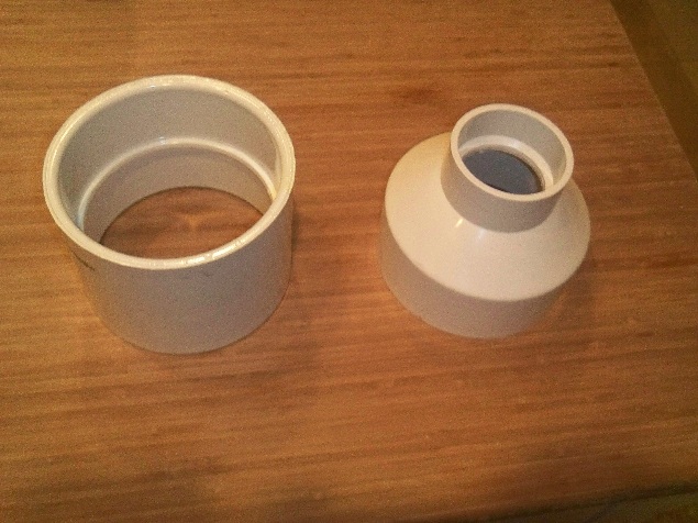

I would rather be sure before I glue:
I plan on building a revised version of my first cannon.
http://www.spudfiles.com/forums/my-firs ... 21876.html
I want to tap in the fittings into two layers as advised, and replace the DWV end cap as suggested.
I was not able to obtain the same pressure rated fittings to go from the 4" pipe to the 1" for the valve.
I can either use this DWV bell reducer to go from my new piece of 4" PVC, or I can cut my old chamber to retain the non-DWV fittings to go to 1", and connect the cut end with my new piece of PVC with a DWV coupling.
The guy at Home Depot assured me that the bell reducer was as least as strong as the pipe, which is DWV, but is rated to 220PSI.
Are either of these options safe, or should I try to get all non-DWV fittings?
DWV fittings question

Never mind what the guy at Home Depot says, he probably doesn't have a clue. For starters, if your pipe says it is DWV but it also says it is rated to 220PSI, then it is pressure rated. You can get PVC labled DWV which is in fact rated for pressure.
Read this article:
http://www.spudfiles.com/spud_wiki/inde ... sure_rated
If it turns out you do have DWV fittings, don't use them. It's simply not worth it. Aside from the fact you'll be wondering when the cannon is about to explode everytime you use it, there is a chance that it really could fail. One DWV part can ruin a whole build, just pay extra and buy the rated stuff.

You answered your own question. It's not rated for pressure. They also have shorter socket depths compared to pressure rated fittings. Stop worrying about DWV, don't use it and you'll be fine.What is it about the DWV that is not pressure rated?

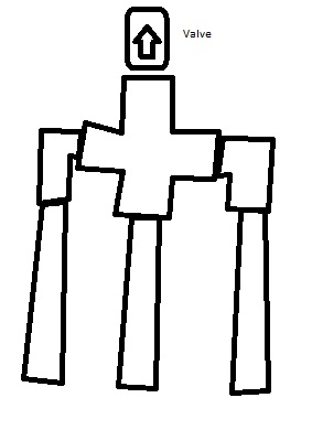

Alright, looks like I am going to change the 4" chamber into one made of 2" PVC, as Home Depot has plenty of NSF-PW fittings at 2" and below.
I'm thinking I'll get a cross joint, and with some 90 degree turn attachments I'll make the chamber out of three parallel pieces of 2" PVC rather than one length of 4" PVC
Is there anything intrinsically wrong with this design?

Nothing wrong with that.mlz3000 wrote:Alright, looks like I am going to change the 4" chamber into one made of 2" PVC, as Home Depot has plenty of NSF-PW fittings at 2" and below.
Not as efficient as a single chamber and straight through. But you've got to be really really picky to care about the small difference.

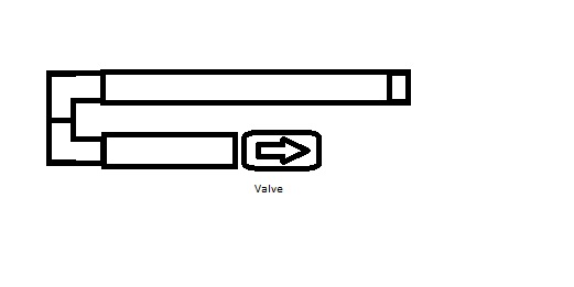

When I think about it, the only aversion to over/under I have is that it is awkward to shoulder mount because the valve is generally at the very end of the cannon. This does not have to be so.
This is the what I'm going to do. That design with the three chambers is unnecessary work and it looks pretty dumb to boot.
- So that there is a bit of stock behind the valve.
