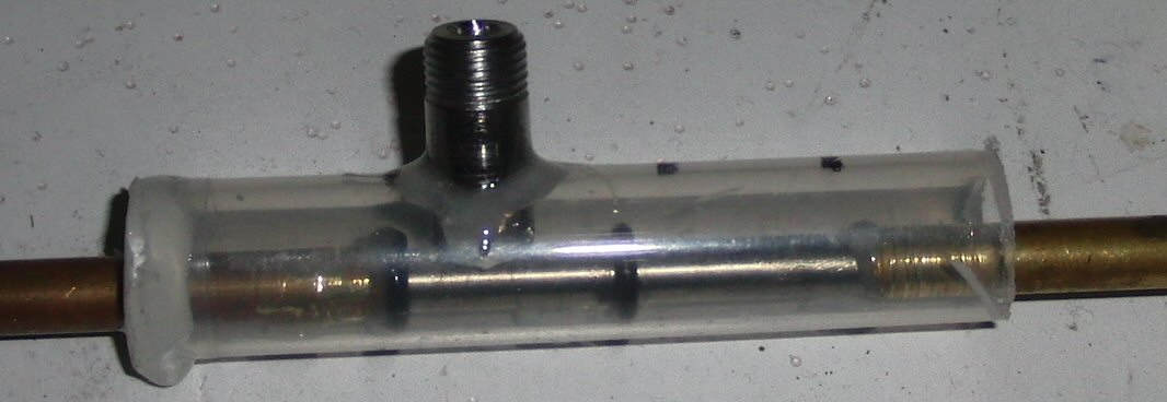

Edit: started construction of a low pressure airsoft calibre blowback prototype as per the above design concept, I'm hoping that if it works the lower specifications will make it more accesible to the average forum member (and perhaps further my epoxy crusade :D) and also I'm casting in clear tubes so the mechanism can be seen internally, this seemed to make the blow forward breech quite a hit :)
Here's the basic breech before pouring the epoxy, you can see the 6mm steel rod (from a printer cartridge, great cheap source) that's serving as a mandrel, keeping the barrel (on the left) and bolt tube (on the right) in line. and the breech and bolt o-rings in place, as well as the 1/8" threaded section to which the blowgun will be attached. I decided to drill out the magazine hole after the cast is finished as opposed to incorporating it in the mould.

Looking good, I like the idea of the clear casing.. Helps everyone with being able to see it at work, rather than just trying to understand :) I cant wait to see how this turns out.
