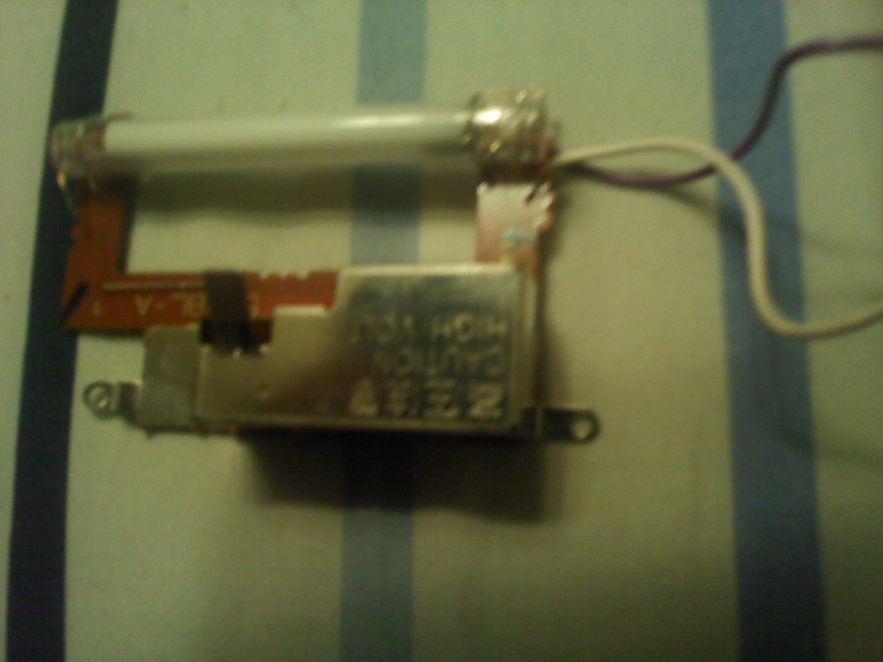

Okay so I was taking apart an old hand-held TV that ran off of like 6 AA's. I come across a circuit board with a metal cover that read "CAUTION HIGH VOLT". Malaysian for "Pull me out!!" It also had an interesting glass tube on it which the picture was projected from. I took the two leads off a board and thats it. Hoping there is anyone who knows a little bit more about these things. I think it might be a miniature flyback setup. Pic below.

The photo is not clear enough to show if that is a cold cathode lamp or a fluorescent. The supply is not designed to handle the current of an air arc. It is designed to start a low pressure arc in the tube. The current is very low and the possibility exists it my produce less than 300 volts, which won't generate a spark in a gap. This is very unlikely to work as an ignition source. The HV warning is to prevent you from getting a nasty jolt. Note, it says Caution, not Danger. This is due to the limited current.

It is the backlighting for the LCD display like tech mentioned.
Not at all useful for an igntion system.

The output of the inverter for the tube is high frequency AC, not DC like a camera flash. The current is limited to regulate the lamp brightness and save battery power. The lower voltage and current limiting for the bulb makes it impractical for an ignition.

So why does the cover say high voltage? I really want to understand the circuit better, I haven't ever came across something like this before. That is definitely it on the link.
I'd disagree that it's useless for ignition, if it's output is HF AC then you can connect a Cockcroft-Walton voltage multiplier

The multiplier may be able to make it useful. Fast recovery diodes will be needed.
