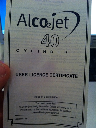

Went to Woolworths this morning and picked up a sodastream bottle..
Im 90% sure the ladies there have no idea what they are doing, and the same at the Coles I visited the other day.. I think this because it costed me $11.70 for the bottle.. Im prrreetttyy sure thats just the refill price, and there is a "User Licence Certificate" on the bottle which is supposed to be pulled off and attached to your receipt when you purchase it.. On the certificate it says there is a user licence fee of $28.90.. So I thinks I got a bargain...

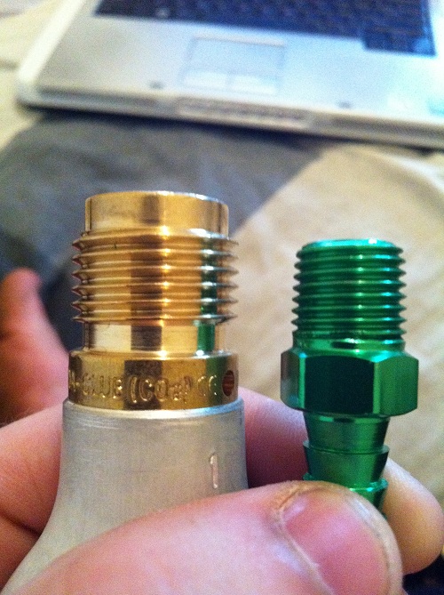

Iv attached a whole bunch of pics of the thread etc so you all can have a looksie and maybe someone will know what it is, and whether it will fit this:
http://cgi.ebay.com/UP-Co2-Plant-Aquari ... 652wt_1008

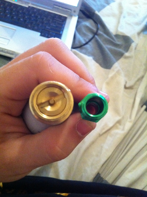

As you can see inside the thread, there is a pin valve, but it also looks like this pin valve can be screwed out.. If its possible, I could empty the bottle (I have no idea how yet, ideas?) screw out the pin valve, throw the reg on there, and fill up via the reg output, and adjust it to 0 output when its full. Then it can be disconnected, attached to the gun and adjusted again to the required output..
So for now I just need to figure out how to let out the CO2 without it resulting in the bottle punching a hole in the wall of my house.. Ideas on this would be great.

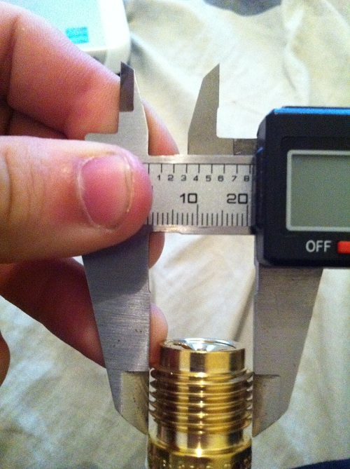

Verniers read ~21mm
Verniers read ~21mm

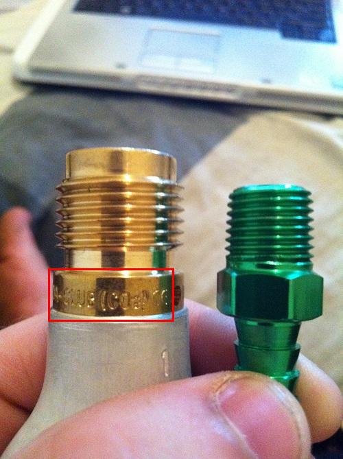

Thread width comparison, and valve screw
Thread compared to a 1/4'' npt or bpt, dont know the difference

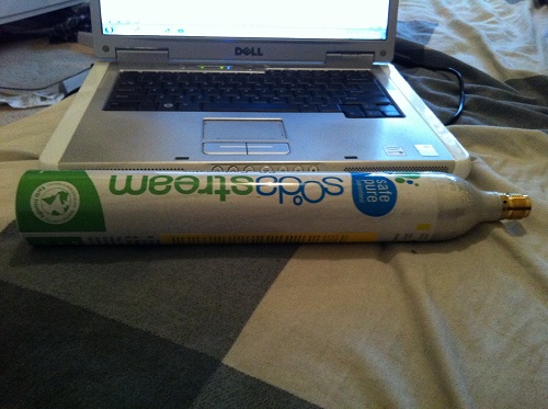

Size compared to my laptop
Licence Agreement
Licence Agreement

I had the same luck when I got mine, they charged me refill price and not bottle price so it cost me like $8NZD. Is there a tiny screw or such on the threaded adapter? Unscrew that to bleed the bottle of all the CO2.
My bottle has 3/8" BSP male threads which screw in to the brass adapter, perhaps yours will be 3/8" female. I've found no use for the bottle really, the brass adapter is too stiff and annoying to be used for a hammer valve. While the bottle could handle quite a bit of pressure, it's heavy, small volume and has terrible flow so it doesn't serve much use as a chamber. Not for me anyway.

It'll hold 1000PSI easy, all you need is a means to pump up to that presssure. Are you making your own hammer valve for it? You wont be able to use the brass adapter unless you can do some machining. It just doesn't seem practical enough. A homemade one, I concluded, would be much easier.

To bleed off the CO2, using winter ski gloves and goggles to prevent frostbite, holding the bottle upright the pin can be pressed with a small Phillips screwdriver. The bottle will become cold as the liquid boils off so it well take a while and you may want to do it in several short sessions.
I do not recommend trying to remove the valve while under pressure as something could go wrong. Pushing the pin will provide a margin of safety as it will close when you release it.

Cheers for that.. I actually just held the bottle and pressed the pin on a pointy edge of my vice.. CO2 sprayed away from my body and all was well :)

Why not just use the bleed screw? It's there for a reason. It looks pretty similar to the one that was on my bottle. If you just gradually unthread the screw it will bleed a lot faster than depressing the pin. I originally tried depressing the pin (which is a right pain in the ass to begin with) until I did some searching and realised that there is a bleed screw on the side of the adapter.
Gloves are probably a good safety precaution though it is quite easy to control the flow of the venting safely.
edit:
Looks like the bleed screw is on the side after the writing shown in this picture:
