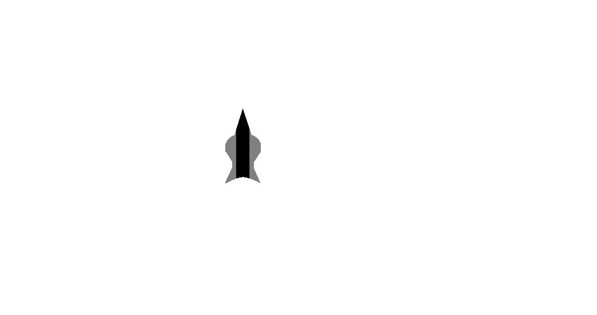

Hi every body, a little question, is a rifled barrel really helps a lot on accurancy? I usually shot bbs, and it's easy to find rifled bb barrels. But I want to build bigger bore full metal sniper rifle, so just want to know if a rifled barrel makes a big difference. On my bb guns it looks no big difference
and if it helps how can I rifle a metal barrel? My idea is make some thing simular to this
http://www.spudfiles.com/forums/pneumat ... rt,15.html. The pic is the pellet I'm planing on
- 未命名.JPG (14.18 KiB) Viewed 7892 times

i'm going to use a 8mm dia barrel, and i will make some metal pellets with exactly the same dia. So the conclusion is it's not necessary to rifle a barrel? I know my projectile aren't soft, I'm looking for penetration power too
If you're not using something significantly soft, you won't notice any difference, and you'll have lots of scratches inside your nice barrel. Power won't (or shouldn't) suffer noticeably from rifling.wyz2285 wrote:So the conclusion is it's not necessary to rifle a barrel?
Personally, I'd get two barrels and rifle one, then see if you can find any ammo that'll take to the rifling.
The rifling is not used for power, it's used for accuracy. If you want both out of a homemade launcher, your best bet would be to put a forward center of gravity (FCOG) on the round, much like a standard slug for a shotgun.
The option for a sabot in a rifled barrel exists, but this is much tedious work and you probably won't notice a performance increase by simply applying the FCOG round to the launcher.

I know a rifled barrel won't increase the power
I'm looking for both power and accuracy. If the pellet has some rails on it to make it follow the rifle line will that help? But that would reduce the velocity of the pellet so do the power
Well, I guess, technically, you could put rails on a pellet to make it catch the rifling, but that's getting to a whole new meaning of the word "complicated." Just try the FCOG round. You won't be disappointed.
Oh, and if you are worried about a specific round reducing the velocity of the shot, compensate by turning up the pressure just a tad.
