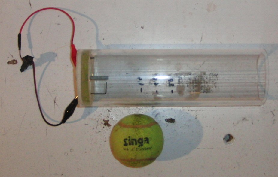

I recently changed the dessicant cartridge on our FT-IR spectrophotometer at work, decided to keep the acrylic tube it was housed in. Turns out it's a perfect fit for a tennis ball, so I made a simple launcher (ie closed one side with an epoxy endcap fitted with electrodes) do do some high speed testing.
By altering the position of the tennis ball, I was able to show the effect of having ignition at the rear, centre and front of the chamber. Note that it was deliberated filmed in low light in order to better show the progress of combustion, enjoy :)

Here's the simple setup with piezo ignition, note the somewhat singed surface of the tennis ball :D
