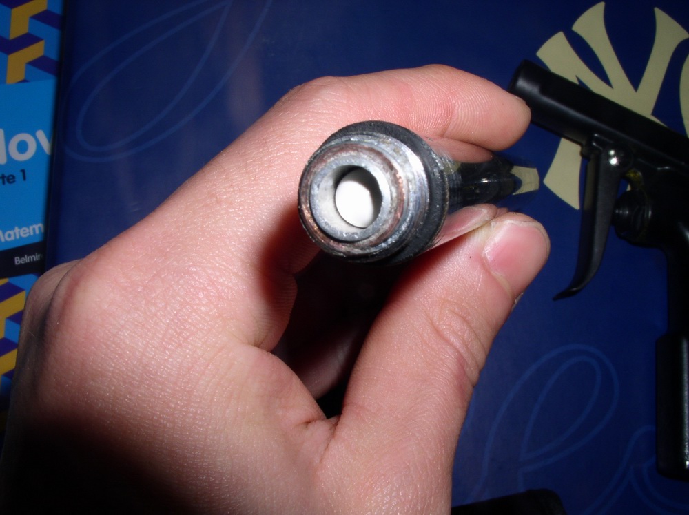

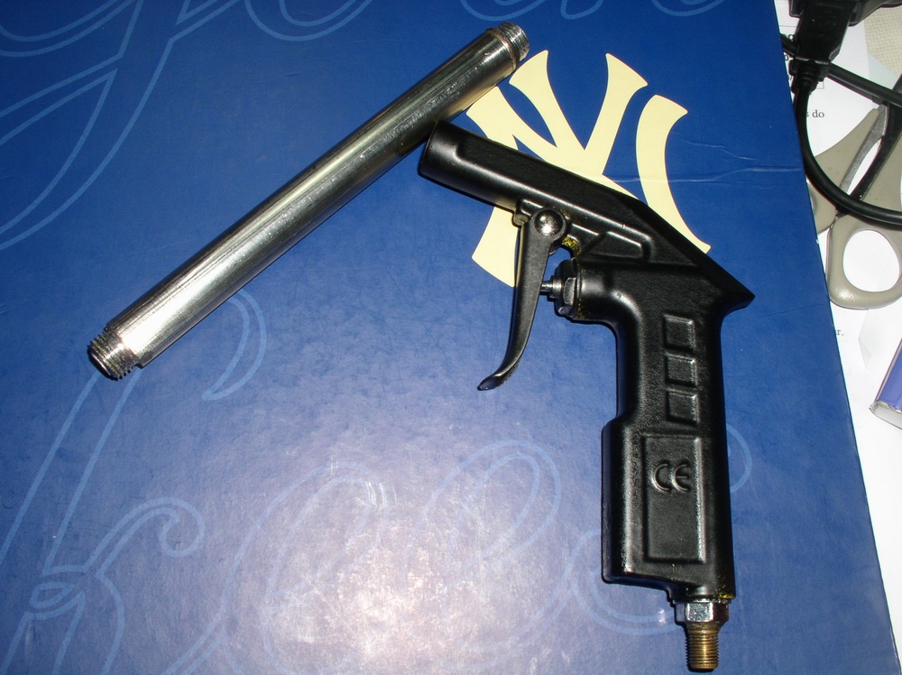

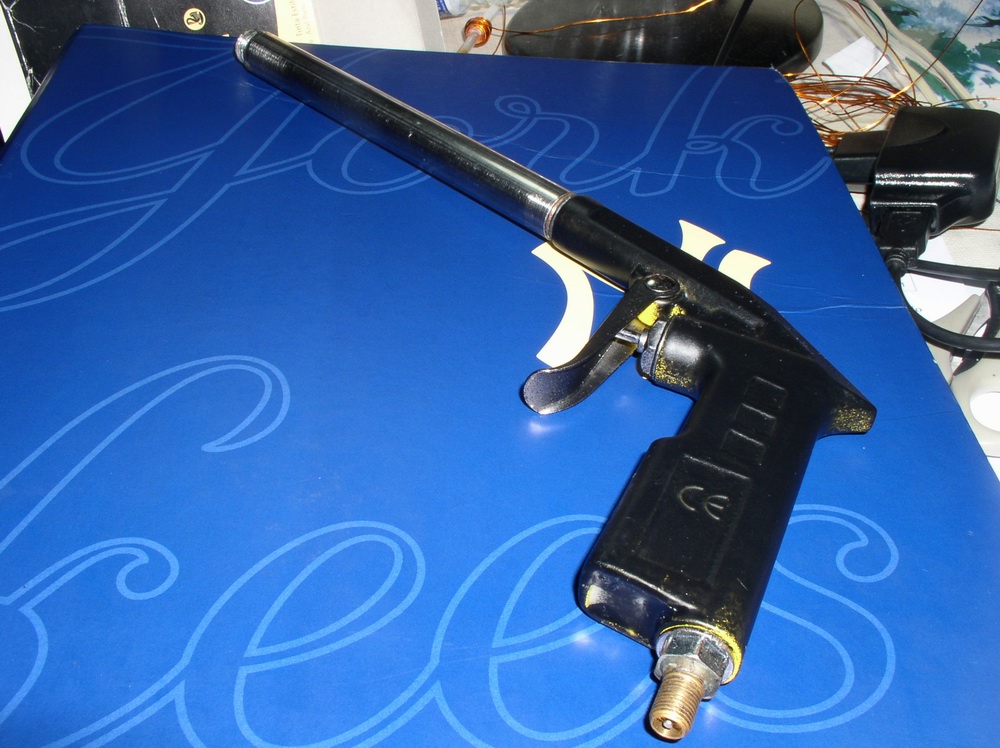

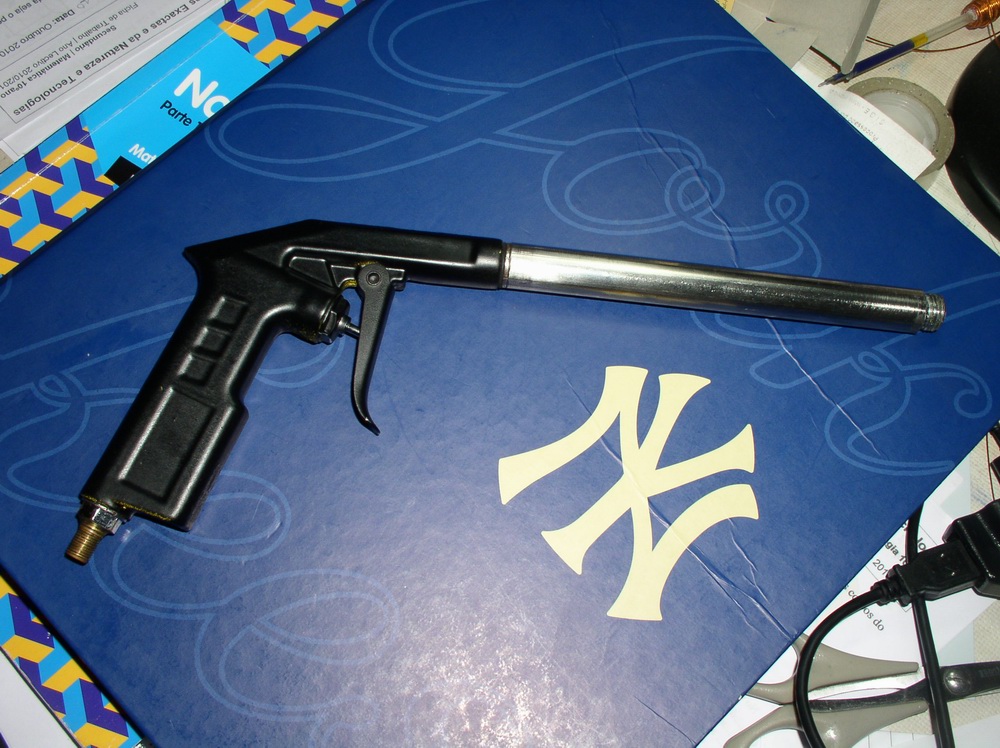

Thanks to JSR's valve less design, I built this semi/full auto pistol. Really like it makes me remember the magnum:D and looks like the first semi/full auto pistol around here
.The barrel has a suppressor and a 1/4 male connection to a additional silencer, the gun is a mod blowgun, now it has much more space for chamber
Haven't get a shock pump yet, so only tested at 100 psi, for 2 semi shots

The thing I don't like is the dead space betweem the valve stem and the actual barrel. Also, what size is the barrel? It looks like a regular pipe nipple.

Very nice! Needs higher pressure for moar powah/shots per fill, or you could connect it to a paintball tank via remote line
In this case, it's not dead space because in the valveless/pop-off principle that space between feed valve and breech is actually the effective chamber volumeVincenzo wrote:The thing I don't like is the dead space between the valve stem and the actual barrel.

Yesmore_eggs wrote:Lookin good dude... Is it barrel loaded?
I'm guessing u drilled out and sealed the handle to make a bigger chamber space?
@JSR I thought the space between the schrader valve and the valve stem was the chamber.

That's what I thought. So, the space between the valve stem and the barrel is dead, correct?

No, it's not dead space. Dead space is the volume between the main valve and the initial projectile position. In this design, there is no main valve, the projectile acts like the valve. Therefore, zero dead space. The space that you're calling dead is the volume that depressurizes to force the projectile down the barrel (effective chamber volume).
This may just be a semantics confusion...

Ah, very nice, simple and clean. I really do like the simplicity of this particular build. It really is a shame that you don't have a shock pump yet, I'm interested as to how loud it is.

Well I bought it todayMr.Sandman wrote: It really is a shame that you don't have a shock pump yet, I'm interested as to how loud it is.
