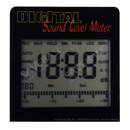

Study them before purchase. Some are averaging. Some record peaks. Most have weighting. Some frequencies are more damaging to hearing.
What exactly are you trying to measure? Is it the crack of sound of gunfire? If so you will want to upscale from one used to measure OSHA sound compliance at the local band.
Some are more sensitive than others. Some won't register the sound level in a quiet office. Others won't register a nearby jet.
Find one that meets your requirements. Do you need to measure below 60 db or above 120? Do you need to measure peak pressures?
note the display from the first choice in the list. it has A and C weighting. it has peak and average reading.
It's range is 40 to 130 DB.
It will record a peak pressure.

I would not buy that one for use with a band sound system. It's frequency range is way too limited.
From the specs..
# measurement frequency range: 300Hz ~ 8K Hz
It would be useless for balancing the drum set and bass guitar.
The stuff I use is flat from 20Hz to 16KHz. I can measure the rumble of the building ventilation system. That one won't measure a quiet studio's ambient noises.
Other than the limitation of prosumer goods, it is good for general ballpark measurements.
A good omni reference mic for use on upscale equipment costs more than that SPL meter.

My experience with fairly cheap dB meters (same sort of price range) is that they'll average too much to really be useful. The Fast and Slow settings mean they'll either average over about 1/10th of a second or a whole second. This, of course, is far too long to get a good peak reading of a firing crack.
I have found a way to use it meaningfully, using it to get a reference dB level for a steady sound, then using a separate sound recording to compare the reference sound and the peak level (in Audacity, or something similar), then working out what the peak dB should be from that.
But it's no good for recording the dB level of a report directly.
It might give you a vague comparative measure, but mine usually reads well under 100 dB when I've tried it for measuring reports, and that's clearly false. Done in such a way I get a proper reading, I've recorded SPLs of nearly 160 dB @ 1m. (And you wonder why I use hearing protection.)
That's a discrepancy of in excess of six orders of magnitude. In short, don't expect it to read "gunshots" properly.
