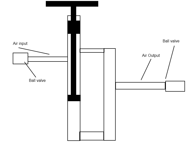

Hi guys,
After browsing the Forum for topics about homemade pumps, I came up with the idea of a pump that could some higher pressures, because a little part of the pressure in the "Chamber" is used to press the pump down which helps at higher pressures one couldn't archieve by hand. Think the pic attached could work? the part between the pump and the chamber would need another BV I didn't draw and ofc the lower connection would be a onewayvalve

Flawed plan.
Push the pump piston down and all you're going to get is the air flowing back behind it.
The air pressure will not only be pushing downward but upward as well = no gain and a huge amount of dead space.
Agreed with Hotwired. If you want high pressures, your best bet is probably just a small-diameter two-stage. But don't let me discourage you from coming up with designs... you may very well hit on something that allows the air pressure produced by pumping to assist. I've got a few ideas bopping around in my head now from that design...
EDIT: Would this work? Assuming that the black rectangles at the top of the pump are seals, and that the pump head has a floating o-ring like the ones on Tech's pistons, not a normal pump head.

That "static high pressure" area would vent to be atmospheric before you even began pumping. Even if you found a way to seal off an air assist line, it would still deplete into the air being pumped into the compression chamber by the piston head, by virtue of the floating o-ring.

I understand how the section of high pressure could leak to atmospheric, but vent? Explain...
Okay, so maybe a floating o-ring isn't such a great idea
. But a normal o-ring would probably work...

TBH the original plan looks like it was hoping for a free lunch in the slaving-over-the-pump department but no such luck.
However it is entirely possible to use a hand pump (or any pump that can deal with the pressure) to further pump and compress pre-compressed air, that is a saving of work as long as you are not personally doing both stages of compression.
For example, you feed your hand pump 150psi from your workshop compressor and then squish it to say 300psi, very doable.

I know it has some mistakes in it, but I kinda like the idea. I'll work on it some more in the future. I'll update the post when I have made a nice animation of it
