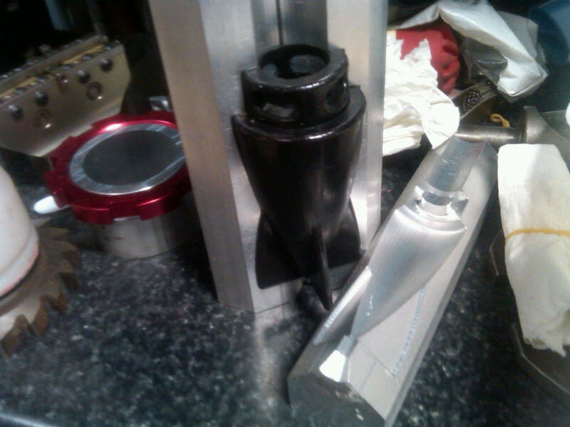

Check out Polytek products. Their polyurethane 2 part pours easy and hardens in a couple of minutes. The Pic is how we made the body of our prototype CR80 rounds. Once cured we fill the hollow area in the center with foam, add steel nose weight and over mold with 40 or 50 durometer rubber nose cap... also from polytek.
Mold release is key, I know from experience.

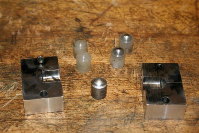

The plastic ones in the pic are hdpe, made with an injection molder in the mold shown. 3/8" ball bearing tip on a couple of them.
Honest opinion? Too light, and not worth the effort. Did NOT survive when fired. Simple cast lead is easier, and works better.
Think I have some pics somewhere where I used a 1/2 ounce fishing sinker encased in the plastic in place of the ball bearing....those fit the bore well, and had enough mass to work nicely.
That cast in a "foster slug" shape with a consistent metal weight dropped in the nose (say a ball bearing or a nut) should make for a damaging and accurate projectile that's relatively easy to mass produce - which would be an asset, considering that it's highly unlikely to be reusable if used against hard targets.Gippeto wrote:Lowest cost (and easiest) option (around here...don't know in Croatia) would be the previously mentioned fibreglass resin.
