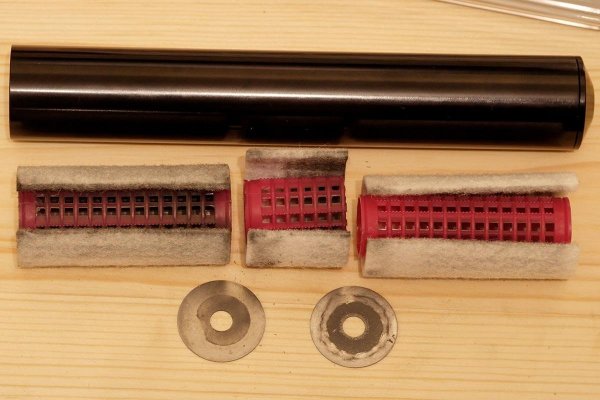

your supressor needs to have more volume, most likely, and try stuffing it with steel wool like velocity3x reccomends
I would say more volume is more likely to make it more effective that steel wool. The latter is useful in suppressors for combustion based launchers where the heat of the propelling gasses is proportional to their pressure.
Many commercial airgun suppressors, like the Weihrauch pictured below, which is considered to be very effective - use a more fibrous synthetic material that feels a bit like a scouring pad - oh, and hair curlers apparently :roll:
