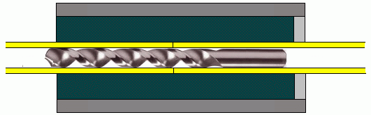

different sizes can easily be used to make a solder joint on the middle. At least in Norway, there is a short supply of solder in epoxy kingdom...
This is how I would do it, using a drill bit or similar to keep things centered, adding a sleeve and filling the space between sleeve and barrel with epoxy:
Why not get a pipe that fits perfectly outside your barrel and sleeve the two barrel sections inside that? Solder or epoxy and you are done, much easier :)
However you might be better with Epoxy and "Function over form!"
I assumed that a perfectly fitting pipe might not be available, as more often that not I tend to work from a stock of material instead of purchasing specific parts for the project at hand.
