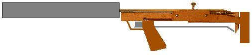

This is a gun I made a few days ago, together with a friend. A second one is being constructed in a while. (you can see the basic system lying in the background)
It uses a piston valve mad out of an aluminium tube, with a bicycle inner tyre epoxied on. The rubber doesn´t get cut.
The pilot volume is about 1.5 - 2 ccm, and it is filled and piloted by a presta valve.
The chamber is a 25 cm long 12 mm OD 10 mm ID copper pipe.
The barrel is 8 mm OD 6 mm ID aluminium tubing.
I use the gun up to 11 bar (160 psi) right now. Power isn't great, but when I get a shock pump things will be better :)

Labtecpower wrote:I use the gun up to 11 bar (160 psi) right now. Power isn't great, but when I get a shock pump things will be better :)
I'm in EXACTLY the same situation right now. The parts for my super-simple track pump come in sometime tomorrow. Just a tip, I found that a lot of bike shocks come with a pump for maintenance, but people turn around and sell those on eBay because they've got a (admittedly) better pump. Might be something to look into...

The second gun will be pretty similar, but the sizes will be somewhat different. The whole gun is made in a way, that it fits like a glove, and for every person, the dimensions differ.

Labtecpower wrote:Maybe i'm going to make my own pump, shock pumps take a long time to pressurize a chamber, from what I heard.
With the small chamber on this gun (only 19.6 mL), a shock pump shouldn't be too hard to use. However, if you plan on increasing the size of your air chambers down the road, a track pump configuration is much better. Have you seen Gippeto's pump tutorial?

I'm planning a similar one. Does the valve do its job as pilot? I couldn't decide between a blowgun and the valve like you did?! I think the solution with the valve has an advantage because theres only one hole to fill and exhaust, and less place for leaks.

The valve works perfect as a pilot. One very important thing is that your piston fits very well. Mine has a 0,01 mm gap. (for size comparison: that's about 1/5th of one of your hairs)
Also make sure that you have a very small pilot volume.
This design is very easy to get leak-free. With my copper gun I had very much problems with a leaking blowgun and piston. (now it is completely leak free tough, I machined myself a nice nylon piston)

Labtecpower wrote: One very important thing is that your piston fits very well. Mine has a 0,01 mm gap. (for size comparison: that's about 1/5th of one of your hairs)
.01mm = .00039"....That kind of tight tolerance requires pretty good machines and skills. Just curious but with that capability, why are you not making your builds using mostly machined parts?

it's a piece of high-precision tubing.
bragging
I'm able to machine in tolerances that tight... for my copper gun I machined a nylon piston with a gap just as little as this one.
For my qdv, I made a piston wich was EXACTLY 42.00 mm. The imperfections were in the 1/1000th of a mm range.
/bragging
The only reason I don't machine my guns entirely, is that it costs too much time. It's all done on a hand lathe, but in a few years I will be able to make things on a CNC lathe & mill.

Pistons don't need to be very tight, actually. You can easily make up the difference with a couple of o-rings. If you're just relying on a close fit to take care of your equalization, the tolerances required are nowhere near 0.01mm... more like 0.1mm
