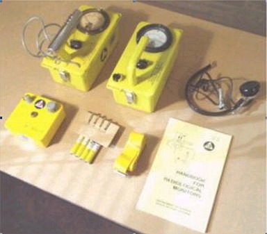

I've got a GM counter (CDV-700) and a "pancake" ion chamber survey meter (CDV-715), and several dosimeters (CDV-750) with their charger, all are cold war surplus. The manuals are interesting.
The GM counter measures background radiation without any problem, so any radiation (most sensitive to gamma, OK sensitivity for beta, useless for alpha) above background is easy to detect.
The ion chamber detector is more along the lines of "too late now you are already dead" level of sensitivity.
Couple sources that are fairly easy to find (the GM counter has a built in test source of unknown, at least to me, composition):
1. Coleman Lantern mantles (surprisingly hot due to the use of thorium)
2. Pottery and marbles tinted with Uranium Oxide ("Depression glass" and "vaseline glass")
3. The Americium-241 source (~1uCurrie) from an ionization smoke detector (extremely illegal to disassemble that kind of smoke detector
4. Salt Substitute (KCl, from the grocery store) is just barely active above background.
Looking at Ebay postings, the price of this setup has gone up as much as 10X since I bought it a couple years ago. I suspect most of that run-up has been in the last couple weeks.

- Top row, L to R: GM Counter, Survey meter, crystal headset (for the GM)
Bottom row, L to R: Charger for dosimeters (IIRC 200 volts from a pair of D batteries), dosimeters, shoulder strap for meters, manual. - cdv kit.jpg (27.75 KiB) Viewed 5189 times
