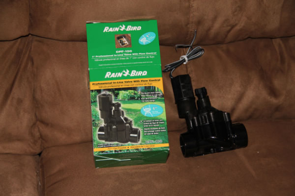

Rainbird CP-100 with flow control. http://www.lowes.com/pd_15482-147-CPF-1 ... %2Bcontrol Please tell me how to modify it so I dont f**k it up! I will give you guys pictures in a little bit.

Are you planning on buying one or do you already have one? If you've got it already, take it apart and you should be able to deduce how it works from there. If I'm guessing correctly the flow control knob controls how much the diaphragm can lift off the valve seat. Just remove that knob and drill/tap the hole to the size you need if this is the case.

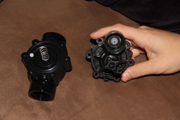

Bleed valve is just above my thumb. I need to figure out how to get the flow control knob off without breaking it. Any ideas? I got most off, just need to get the knob off....

I was thinking you didn't need it, so you could break it. However, that's up to you. After removal, the center hole could be drilled out to 7/16" and tapped to 1/4" NPT threads for your pilot valve.

Ok, I just popped off the knob, I am going to drill it out. Note, this is not the Bleed valve, this is the flow control.
warhead052
- Staff Sergeant 3
- Posts: 1769
I dont have the tap, but I have the drill bit, and my adapter threaded its self in, and its sealed nice and tight, air leak proof. I will add more pictures in the morning. I completed the valve, but it doesnt hold pressure, so I may have to reattach part of the flow control.

Does the spring still have enough length to put pressure on the diaphragm after moving the flow control out of the way? It might be as simple as getting a longer spring, leaving the bottom part of the flow control, or filling the gun from the pilot side.

Ok, well its actually already been tampered with, and there is a slight hole in the diaphram inside the spring area, so I am going to return it, at least I dident f**k around with it too bad. D:

lol its ment to be there, that a eq hole. no jokes
