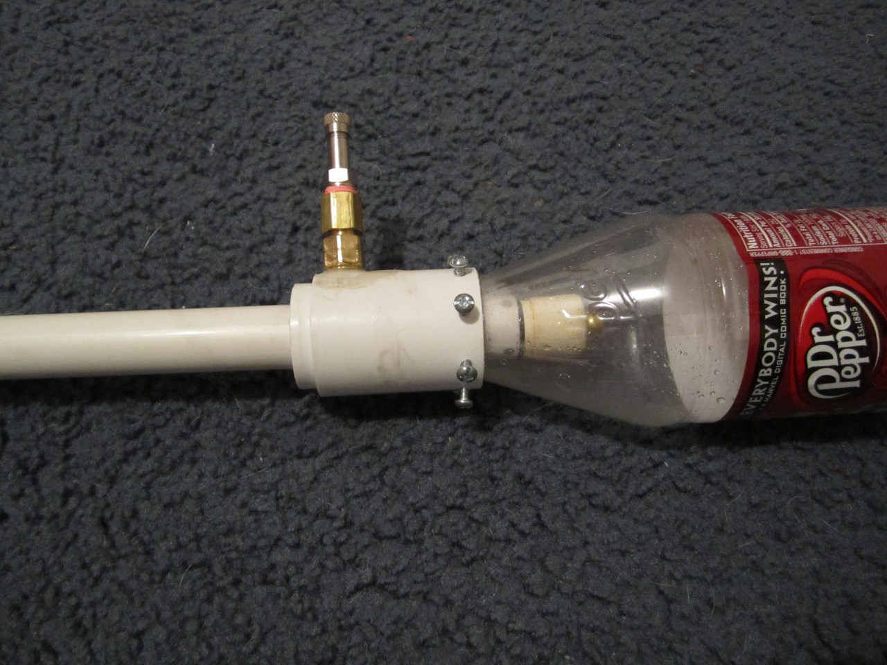

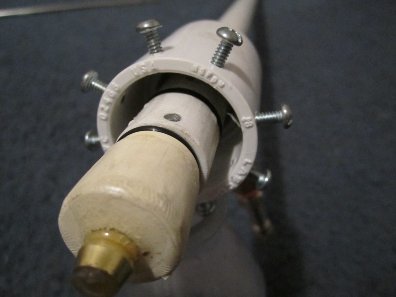

The best view of the internals I have. The o-ring which seals in the bottle neck is visible, but the porting is hidden fairly well by lighting. All it is is four 1/4&amp;quot; holes drilled around the pipe just in front of the o-ring groove. The stop screws grab the lip of the bottle and prevent the bottle from flying away at higher pressures.
The best view of the internals I have. The o-ring which seals in the bottle neck is visible, but the porting is hidden fairly well by lighting. All it is is four 1/4&quot; holes drilled around the pipe just in front of the o-ring groove. The stop screws grab the lip of the bottle and prevent the bottle from flying away at higher pressures.

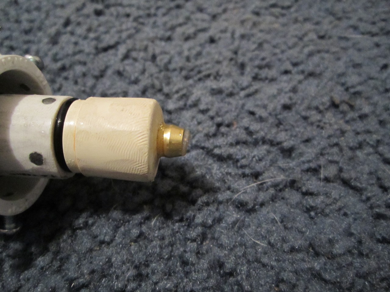

The rear plug. This is some kind of CPVC transition adapter. For what, I don't know, all I know is that it had an end that fit inside 1/2&amp;quot; SCH-40 and a 1/2&amp;quot; CPVC spigot end, and an o-ring. I installed it with #6-32 decapitated machine screws, with moderate compression on the o-ring, with a 1/2&amp;quot; CPVC cap on back. The brass olive is lending some security to the 1/4&amp;quot; fill hose epoxied through the cap.
The rear plug. This is some kind of CPVC transition adapter. For what, I don't know, all I know is that it had an end that fit inside 1/2&quot; SCH-40 and a 1/2&quot; CPVC spigot end, and an o-ring. I installed it with #6-32 decapitated machine screws, with moderate compression on the o-ring, with a 1/2&quot; CPVC cap on back. The brass olive is lending some security to the 1/4&quot; fill hose epoxied through the cap.

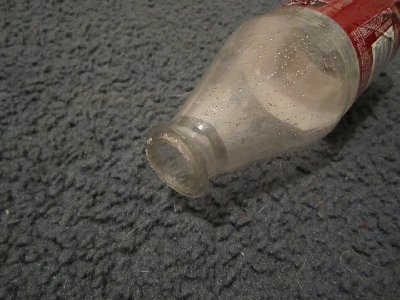

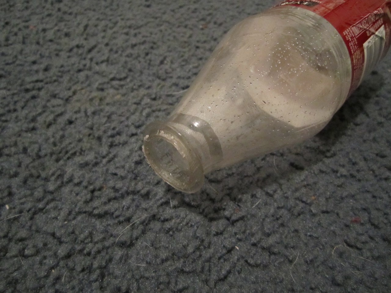

A modified Dr. Pepper bottle. This is done to allow more forward movement inside the 1&amp;quot; coupling, and therefore more flow through the porting.
A modified Dr. Pepper bottle. This is done to allow more forward movement inside the 1&quot; coupling, and therefore more flow through the porting.

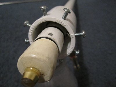

A side view, giving a glimpse of the internals.

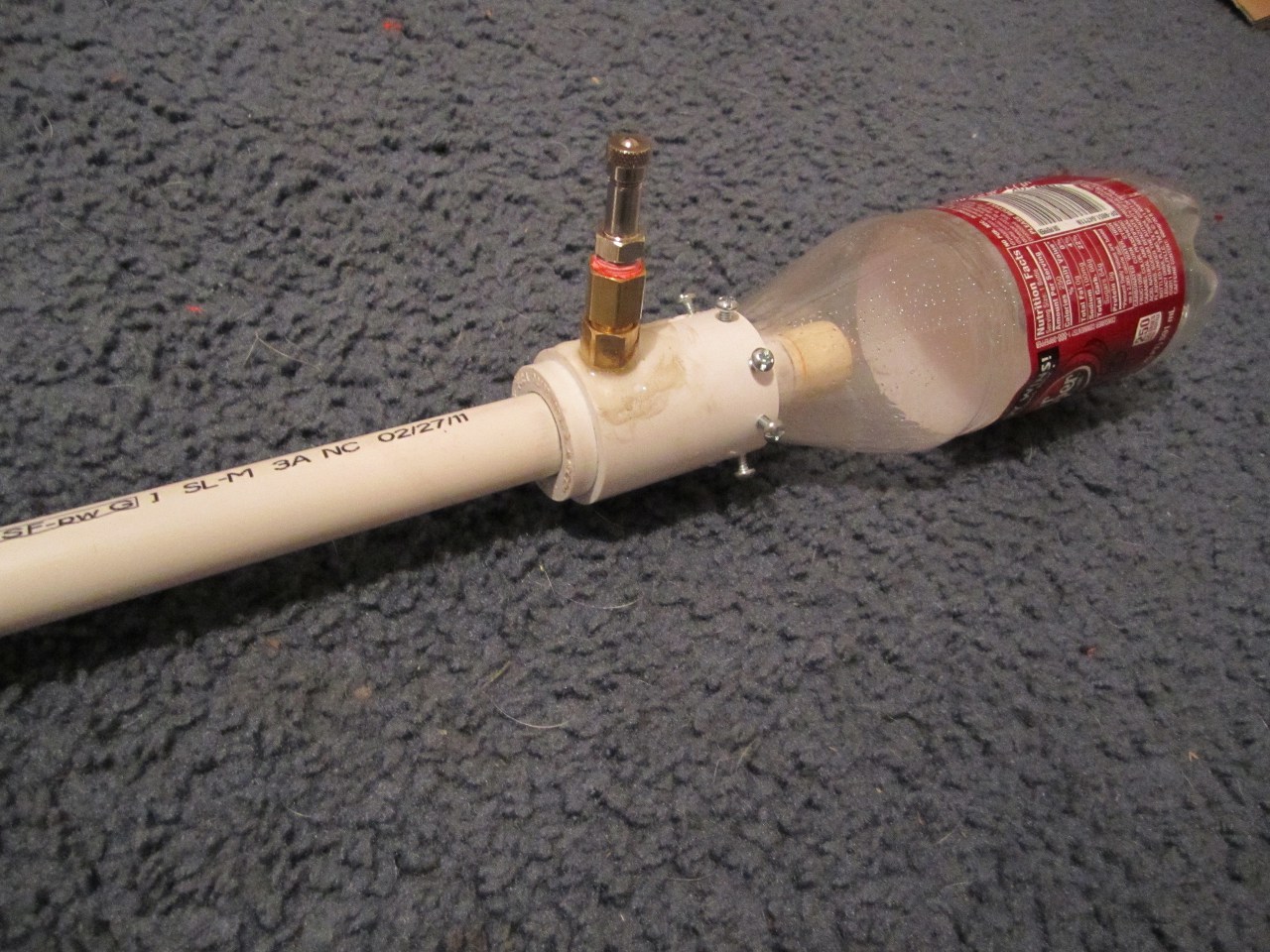

An overall view of the launcher.

... :? I think I like it if it works how I'm envisioning it, care to draw up a diagram?

interesting design.. I understand it now. Fun idea, sort of like a hammer valve in essence. my guess is performance would be limited by the small holes, and air may leak around the outside of the bottle.
Neat concept though, never thought of it before.
