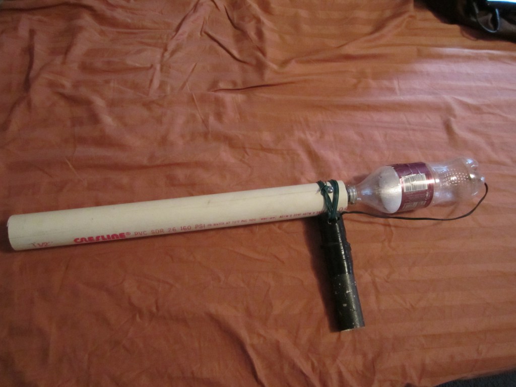

Simple ghetto combustion. Weak, cheesy, and exactly 0 dollars and 00 cents. Had some interesting misfires with this thing, but everything is resolved.
EDIT: Some more info...
All of the pipe was from a scrap pile I found under the house. I had the barrel from a failed burst disk launcher, which was the source of the 1" pipe for the handle and the bushing/coupling used to attach the barrel. The rest is explained in the pictures below.
Fueled by a MAPP torch, a 5/8" flow restriction, and takes a screwdriver and burst disk to reload... this thing sucks! ;) Also, YES, I had everything lying around... more later.

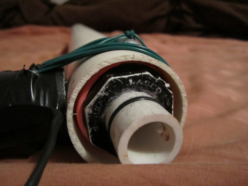

This sort of shows how the barrel is attached. The 1/2" pipe is glued into a 1x1/2" bushing/coupling which was wrapped with masking and PTFE tape and bolted into the back of the barrel. This assembly is airtight. In fact, the whole gun is remarkably airtight without the addition of the 1/8" electrode hole in the back.

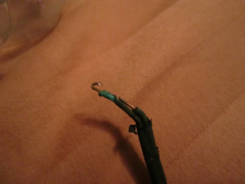

This is what goes in a 1/8" hole in the back of the bottle (the thickest part). It is simply held in by friction, because I had no silicone lying around.

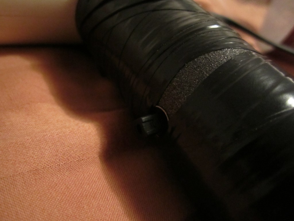

Ignition is a piezo from an Aim n' Flame mounted trigger style in a piece of 1" pipe, which is attached to the launcher with wire.

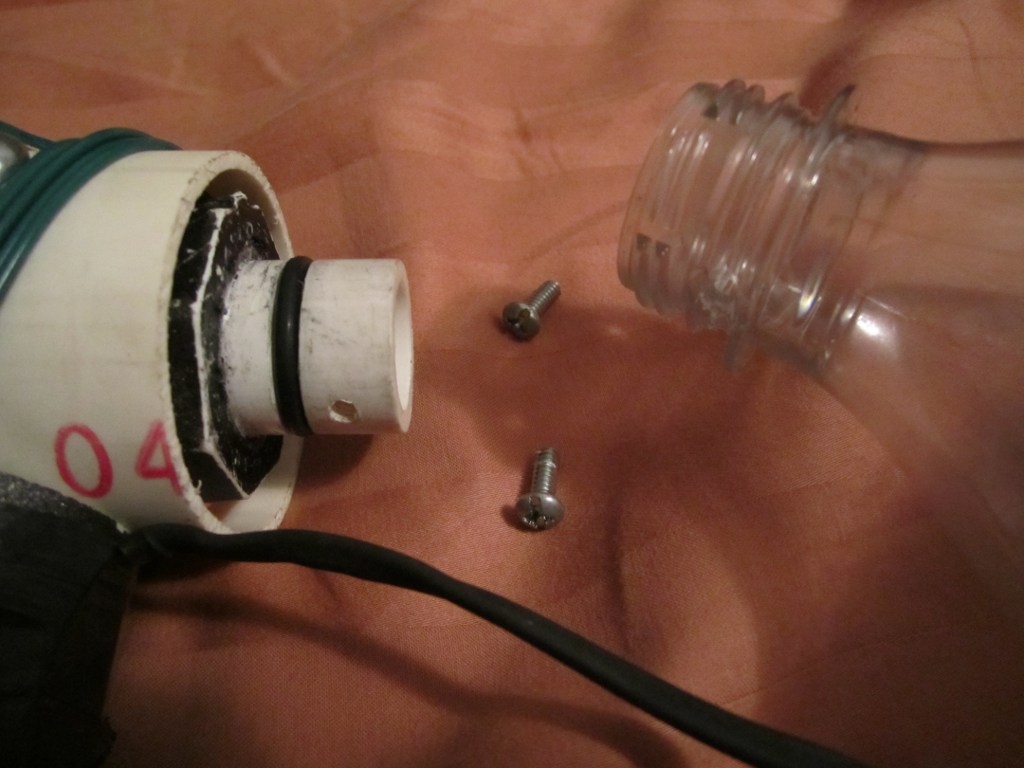

The method of attaching the bottle, a 1/2" pipe stub with an o-ring installed and two holes for #6-32 machine screws.

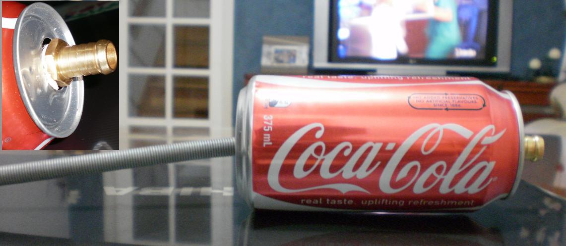

The Coke Can Combustion
barrel: 7mm od 6mm id, Extension spring :D
combution chamber: 375ml coke can, dah.
cost: $0.00
time: 5min
LOLZ: lots :lol:

haha thats like epic :D does it work?
Crna Legija
Posts: 2333
Location: australia
yep i just let about 8sec of gas from my lighter, then stick a long nose ligher in the hose barb at the back and BOOM. I have yet to acutely shoot something out of it.
