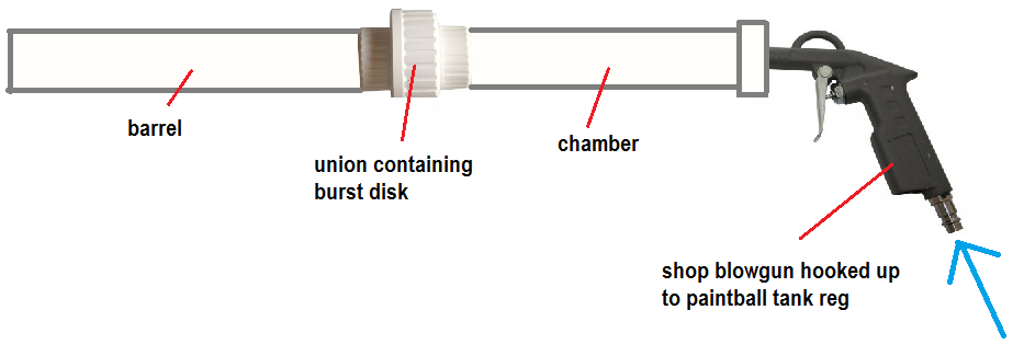

Basically, this is the design I am suggesting:

Well im off tomorrow and im going to swing by harbor freight to look at some of these parts... hoping maybe theyll have the union piece so i can see it in person.
My only questions at this point are 1. Place to get a supply of burst disks? Saw soda cans work ok for about 90psi shots. 2. Material needed to safely shoot? PVC at 100-150 psi or is that in the realm of metal piping? What keeps the blowgun handle from getting ejected instead of the tater...? Or are the ends of the guns threaded? Could just drill and thread a hole into the pressure chamber if thats the case.
Basically I'm just trying to do this so i don't end up breaking my wrist or injuring someone if s.h.t.f.

Do you plan on using a chamber? If not, why? A chamber would solve the problem, provided you have a proper regulator.
Davidvaini uses foil tape. I've used it as well. It works great for this. I've never used a piece of soda can for a burst disk, so I'm not sure what type of pressure it would hold. But foil tape would work, is easier to work with, and can be layered to provide greater pressure easier.
The pressure of the PVC is going to depend on the size and type of it. DO NOT use anything less than Schedule 40 pipe. Also, make sure the fittings are properly suited as well, for that is where most launchers fail to begin with. And, if in doubt, use metal pipe.
The fittings should be threaded. You could just drill and tap a chamber but, honestly, you should go with fittings instead. Safer that way.
Further to Hubb's advice:
erager09 wrote:1. Place to get a supply of burst disks? Saw soda cans work ok for about 90psi shots.
First of all, a given material will fail at a certain pressure for a given diameter. For example, withthis 6mm bore project, a single layer of ordinary stationery tape was enough to hold 400 psi. I am currently using photo paper for my hybrids, two layers for a 3/4" bore will happily hold at least 200 psi. A bit of trial and error will give you the right material and number of layers, the important thing is that your chamber is strong enough to hold the pressure should the disk not fail.
Certainly within the realm of pressure rated PVC - make sure you check out the rating and work within the limits specified. Again you might want to consider metal fittings to work with the 500 psi feed from the tank directly, a small metal high pressure chamber will yield better performance than a large low pressure one, have a look at these calculations. It might be a good idea to download and useGas Gun Design Toolbefore actually purchasing any material, in order to make a virtual model of your launcher giving you approximate performance for given pressure, dimensions etc.
It's assumed the endcap is held on with PVC solvent welding, plenty of advice on the forum. You can drill and thread the endcap and epoxy a 1/4" nipple to keep the blowgun in place which should work well enough for lower pressures, but the better option would be to buy a threaded endcap and get to the blowgun's thread through reducers.
