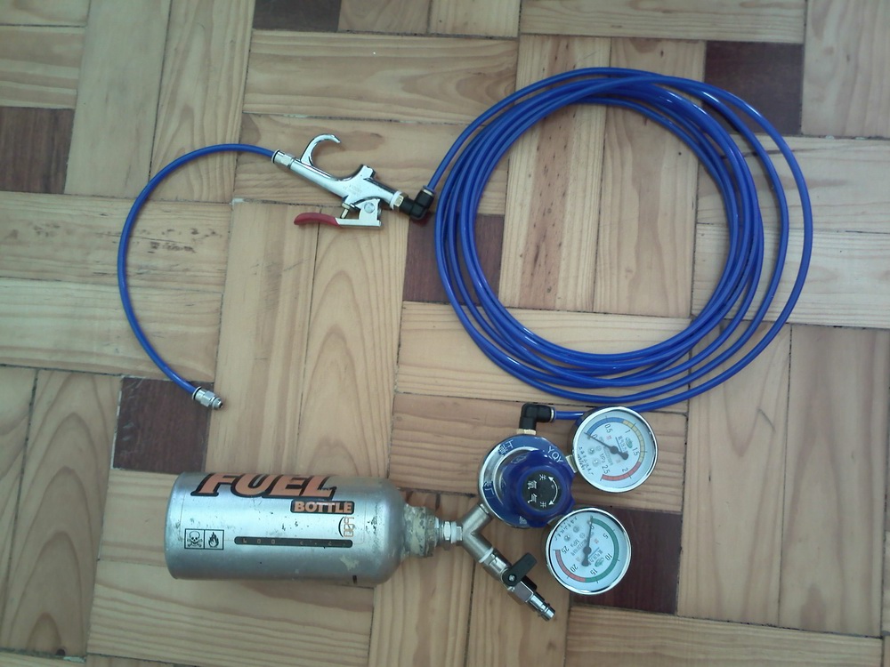

Crna Legija wrote:take it to a hardware store and just test witch fitting fits best, my one was very close to 1/2'' bsp so i just epoxied a 1/2 male fitting in there.
That what I did :P And it worked out fine, but I only used to 20 bar as the bottle won't take more :( still looking for a 2L CO2 tank :) .
This is my bottle with a pressure regulator that I bought and it works great
