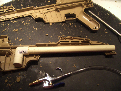

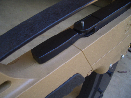

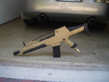

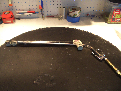

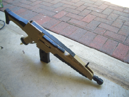

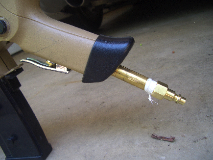

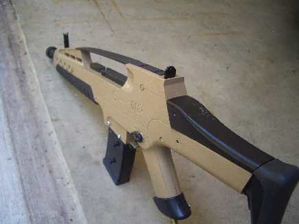

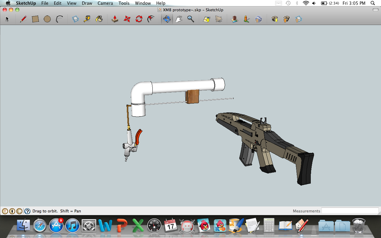

Hello everybody, this is my first BBMG. For this project i decided to go with a cap vortex design since it allowed me to use 3/4 in PVC, which fits in the body of the XM8. This design uses a 13 in PVC tube with an elbow and a cap. the trigger is just a simple blowgun trigger with a 1/4 in brass tube going out of the gun. The brass tube has a 1/4 in quick connect fitting. The other side of the blowgun goes to the cap vortex via a 1/8 in plastic tube which is connected to two 1/8 in brass fittings. The 6mm bb's are pushed into the cap vortex by a plunger. The barrel is 365mm long and about 6.1mm in diameter. Overall this gun performs well; 350 - 400 fps with .12g bb's at 50 - 75 rps. The gun is also very solid and strong. There is a link under this that will take you to a video of the gun shooting and I have also posted many pictures that show how i build this gun. Please leave comments and tell me what you think or if you have any suggesting/ questions. Thanks. (:

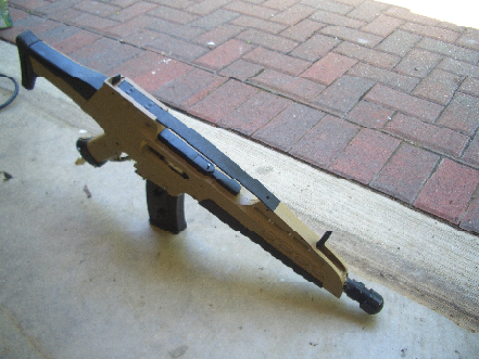

The final product
The final product
The final product
The final product
The final product
The final product
The final product
The final product
The final product
The final product

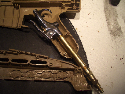

The cap vortex and trigger mechanism apparatus completed

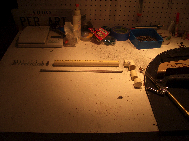

The whole internal mechanism laid out
The internal cap vortex system
The trigger mechanism

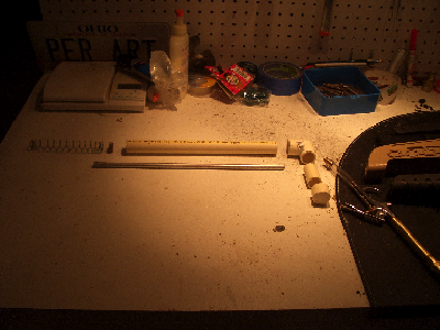

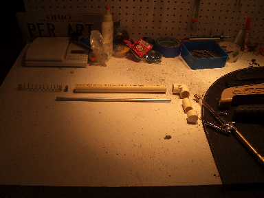

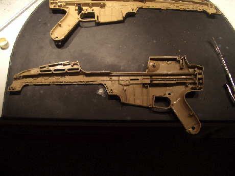

The first part of the build required me to dermal out most of the extra plastic.

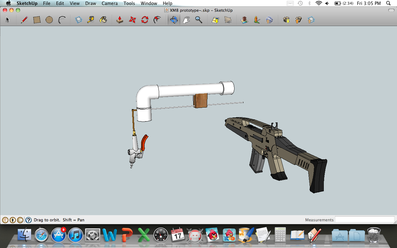

This is the initial design done on sketch pad

Edit, Can you add some close up pictures of your set up? I would like to see the vortex assembly inside half of the body unless I missed the picture...

I grinned out the body to specifically fit the 3/4 in pvc tube
The body
The body

And here is a picture of the interior apparatus

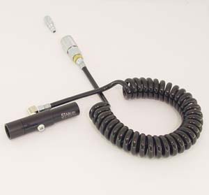

First of all thank you for the kind comment. Second I already have a design for a portable HPA setup. First, you would use a simple 3000/4500 psi 1-2 lbs tank. Second, you would hook up a Palmers Pursuit stabilizer to the HPA tank, which would then hook up to the quick release fitting on the blowgun. This set up would allow for thousands of bb's to be fired on one fill and give you the ability to regulate to airflow from as low as 60 psi to as much as 600 psi. This set up, however, would be expensive, running you around $170 usd.
This is ruffly what the setup would look like.
Female Stabilizer Remote Hose Assembly
