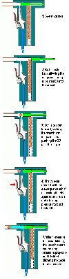

10 points for effort and excellent write-up, I almost feel bad writing the following, please take it as constructive criticism:
- your pilot volume is far too big, I understand you are limited by standard parts but with some thought (and perhaps binary adhesive :)) you can find ways around it. You could have a single schrader as filling and pilot valve with a simple trigger. Aside from power, you get the benefit of compactness and a more "realistic" appearance.
- a scope held by cable ties won't do, consider buying a couple of these - dirt cheap and will fit nicely around a sleeved barrel.
- for a small bore, high pressure is much more important than chamber volume. Unless you want a repeater, I would ensmallen (:roll:) the chamber to 1 or 2 cubic inches and use a shock pump to take it to 400 psi or so, you will appreciate the difference in power.
- if you don't have access to machining facilities, epoxy could also give you the opportunity to make a "proper" bolt action with o-ring seals, something like this:

wyz2285 wrote:jack I tried that bolt action! It doesn´t work :evil: !! once a miss load it stops reload completely :x all the air just come out from the front.
You mean as a semi-automatic? I tried it too at 100 psi and there was too much friction. With HPA or a manual reload it should work just fine though.

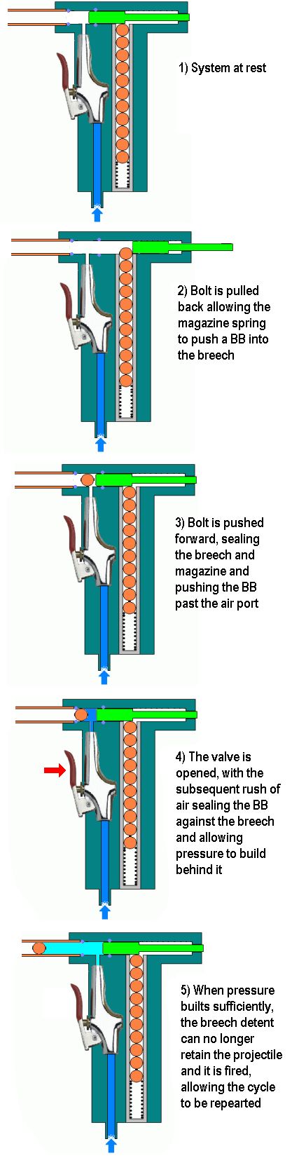

Is there another photo of that bolt mechanism? I just can't see if the outside plastic piece is attached at the back or not
The plastic is just a mould which was later filled with marine epoxy.

jackssmirkingrevenge wrote: You mean as a semi-automatic? I tried it too at 100 psi and there was too much friction. With HPA or a manual reload it should work just fine though.
Hmm I'm still not quite understanding the components of that mechanism...:(

Keringkien wrote:Hmm I'm still not quite understanding the components of that mechanism...:(
Here's the sequence:
Ahh I understand completely now :) Thankyou very much for your help... Unfortunately I will have to implement this design in another gun, I've started putting epoxy on this current one :/ It's going to look like VH_man's "stick guns", muzzle-loading is the only way to do mine currently. But hey! that's ok, More time in the workshop ;) I will post some pics soon of its current shape soon....
