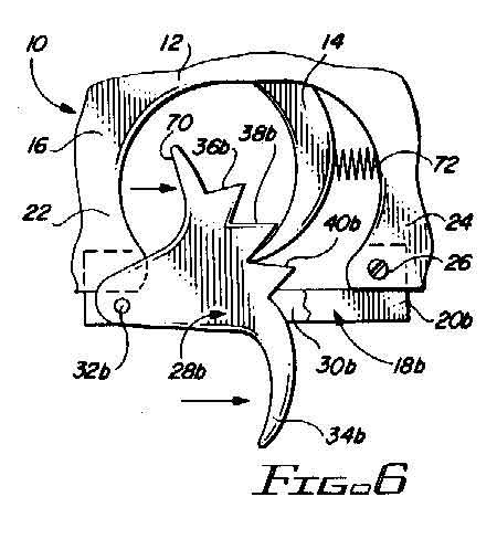

I think I get it now, in the case I read aout there are 2 triggers, the trigger you pull has 3 notches in it and when you pull the trigger the second trigger gets pulled at every notch, the second trigger is what actually fires the gun.
i dont believe that's accurate for all guns, in fact, that picture seems to be a mechanism that would attach to the trigger guard floor plate of an AR-15 to give it 3 shot burst capability, the 2nd upper trigger is the actual trigger of the gun, and the lower exposed one is that add on. i'm not sure how legal that would be, but it would be a great idea if it was in fact legal

atlantis, where did you find that picture? is it a patent diagram?
I believe it is and I'm not taking credit for it.
http://www.antipersonnel.net/links/R006.html
There are a few more complicated ones on the same page.
