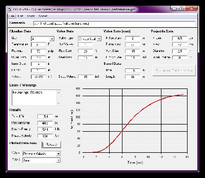

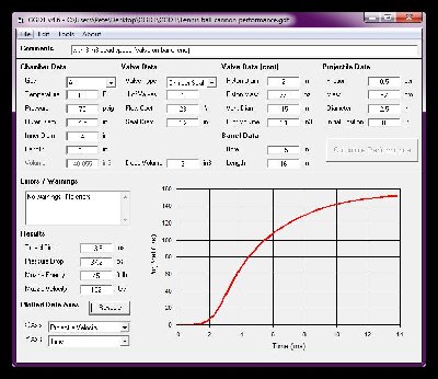

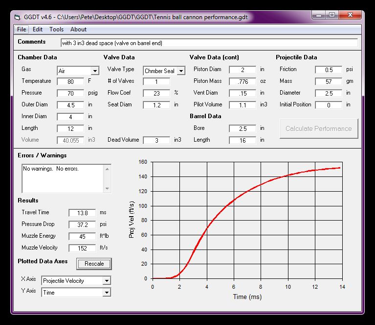

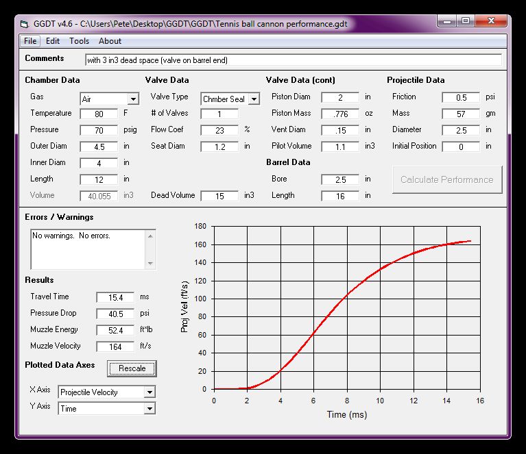

I haven't actually run numbers to get an accurate idea of "dead space", but here is an example with (very) rough estimates. The only variable I changed was the amount of "dead space".
3 cubic inches of 'dead space" - valve on barrel end yields 152 fps muzzle velocity
15 cubic inches of "dead space" - valve on tank end yields 164 fps muzzle velocity
Am I missing something?

Mr.Tallahassee
Posts: 364
Actually, dead space affects velocity like that because of the hammer effect. It's very similar to water hammer. Theoretically, there is a perfect balance of dead space that optimizes velocity. The air pressure has more time to build and that causes the air to heat inside the dead space. Higher temperatures equates to higher velocity. Another odd thing about physics.
For that to be very effective, a high flow valve needs to be used so the pressure can rise quickly behind the projectile and then the moving mass spring off the compressing air in the dead air space. Light gas guns use this effect with a light gas. The extra weight of a heavier gas is detrimental to this effect.
