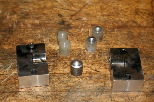

Made these for my copper gun...I DO have a table top injection molder.
An aluminum plate with an 1/8" sprue hole sits on top when in the molder.
Another fellow made a mold and was using it to cast urethane ammo. I'll see if I can find the thread for ya.

Might still be a little info to be gleaned by reading through it though. IIRC, the mold cavity was simply drilled into an aluminum block, with the outer edge relieved with a countersink. Left a small "wedge" shape around the diameter of the base when cast.
Would suggest if you go this route, to make the bulk of the pellet bore riding, and utilize the driving band at the rear to engage the rifling. 5% of total length as a max width for the driving band I would think.

The all hdpe rounds weren't accurate, and I only made a handful at the time. The other hdpe rounds had a 3/8" ss ball bearing in the nose. They worked not bad. Typically hitting "can full of water" type targets at 10 yards reliably.
The lead rounds were good for punching holes in plywood.
