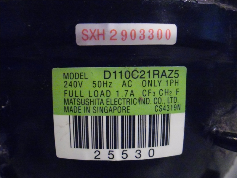

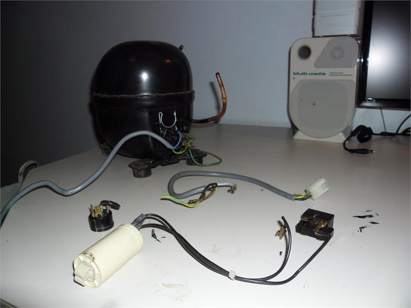

Well, i have this fridge compressor that is in good condition that i pulled out of a working fridge today. I the main electrical cables out with it. When it was removed i plugged it in and nothing happened, so me and my mate decided that because not all the original output cables are connected that there was not a full circuit, so with a bit of fiddling we thought we had it. To our surprise when we turned it on there was a buzz from the extension cable and a unforgettable *POP* from my mates power-box. It seems we blew his shed's fuse and now it has no power D:
So instead of attaching it to the houses supply, i decided to be patient and make a post here, for you more compressor educated few to tell me what to do :D
So, WHAT DO I HAVE TO DO?

do you remember where you cut that capacitor off it will need to go back, then you have to find the two wires the went to the thermostat, ether put a switch there or just connect them permanently and use the power point to turn it on/off.

the one i had wired up had no capacitor, just the three pegs under the black plastic covering. I took the original power cable and just wired the three cables in the power line to those pegs with a soldering gun. Then i interrupted one of the three cable in the power cable with a switch,so i could turn it on and off without unplugging it.

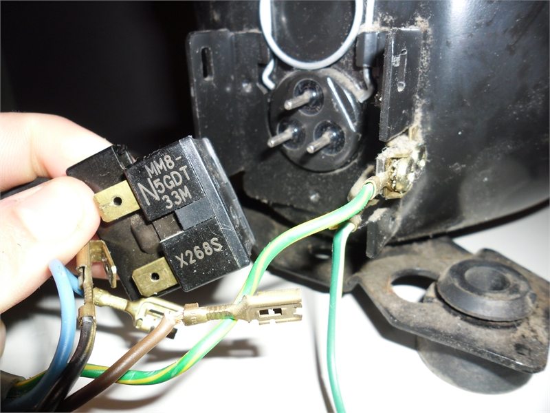

That's wrong.

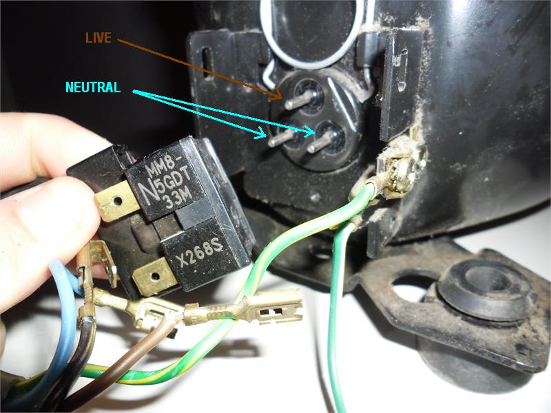

There are 3 pins:
1. common
2. run
3. start
if you have a multimeter you can tell which one is which
that's based on resistance alone
Basically speaking common has to be connected to the blue wire, run is brown and start is connected to the wire that leads from the starting relay.

POLAND_SPUD wrote:That's wrong

lol it might, but it is not the way it should be done. Plus the guy doesn't know which pin is common, run and start (at least I can't see any letters there)
check the video - pins are not always oriented in the same way
(well at least the one presented there has a letter next to each pin)

The original power cable has its 3 wires. 1 of then ran into that box that sticks onto the compressor plug. 1 of them ran into a little cylindrical shaped thing that sat in a little frame above the plug and the other is still attached to earth.
Could i forget about the junk that was hanging off it and hook the mains power straight to the 3 pin plug on the compressor and liquid nails [epoxy eat your heart out liquid nails fixes everything, alongside my ductape and Leatherman] a little switch into one of the wires? Maybe even cut a hole in the plug cover and screw it in.
Professionalism achieved through garbage.
Also, the entire system had a cooling fan which also ran out of the same electrical cables. I don't really give a damn about it so i'd rather not re attach it at all.
