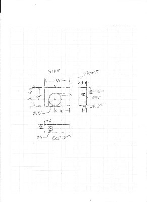

That's very do-able, but not with the skirt on. The skirt would have to be separate. (and those are not plans; no dimensions are included.)

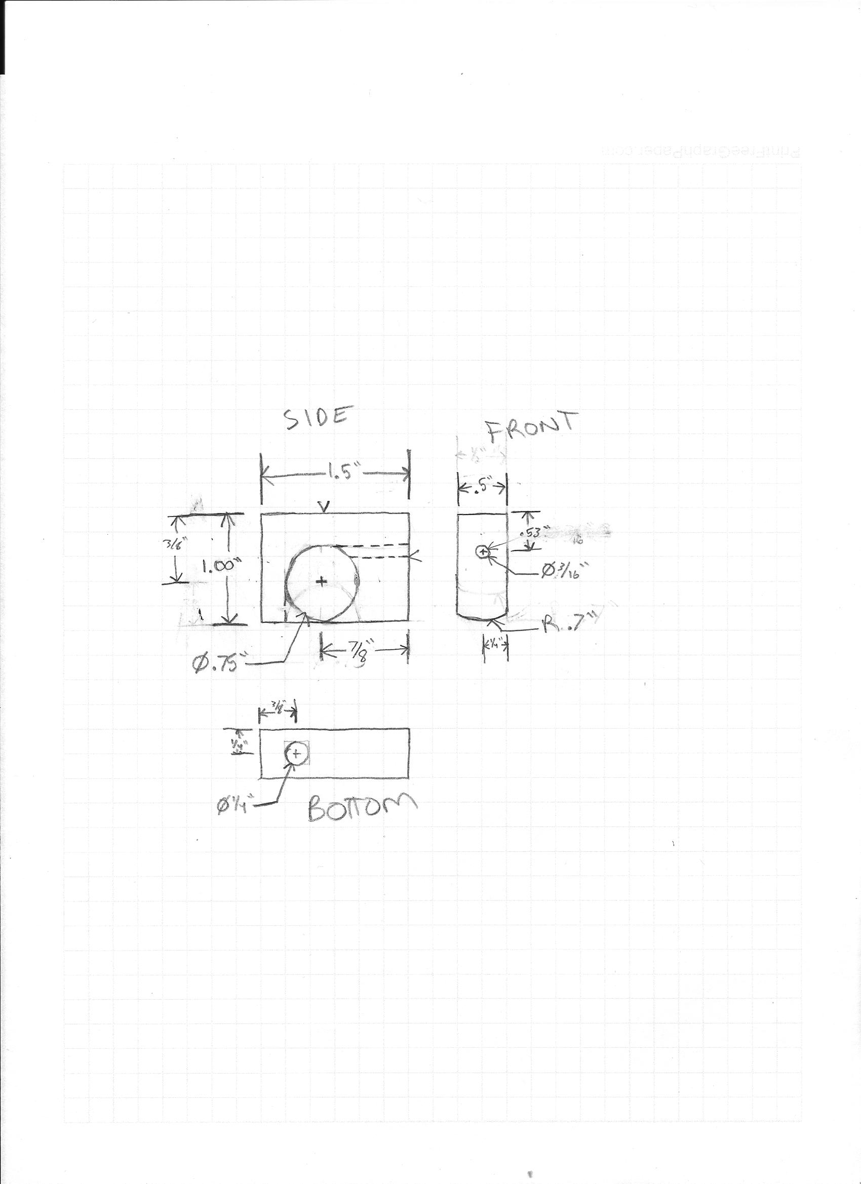

Alright this is the drawing of the block.. let me know if you have any questions.
This is the first draft, do not go out and machine this right away as I may add a bolt hole for locking the vortex block in place, I'm not sure yet though.
Let me ask one question before you get too committed to this.
Why aluminum? I mean sure, it's cool I guess. But Something like HDPE will be a whole lot easier to work with, a whole lot cheaper, and won't be a huge issue if something gets messed up.
Plastics stores aren't that rare; I can go down to my local one and most likely pick up 10, 1" x 2" x 1/2" blocks of HDPE for maybe $5-6.
I could then turn those 10 blocks into 10 vortex blocks in much less time than the aluminum would've taken, at a fraction of the cost. HDPE blocks will last longer than you think, if that's your concern, and would be easily replaceable (you have 9 more, remember?
Aluminum offers no real benefits except for lasting probably forever, and being able to tell your friends you had a part specially machined and shipped to you for your gun.
