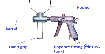

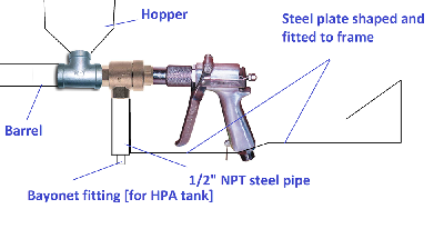

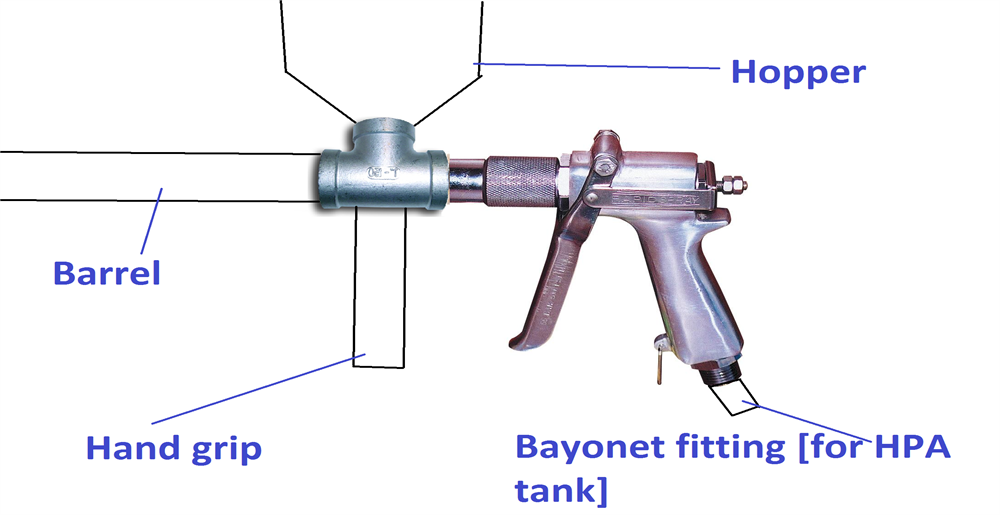

NOTE: If i eventually just get fed up with having to fiddle with nasty little spray guns [i only like them because of the shape, makes it easy to work with] i will just make something like this:
Blowgun without QEV.

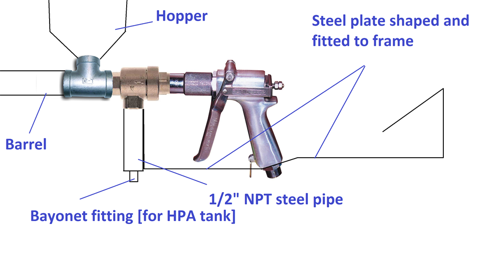

Blowgun with QEV.
Blowgun with QEV.

The QEV will hold more pressure and exhaust will be faster but the second one would work but i think 500 psi would rupture it, im not sure maybe if you have a 500psi blowgun.
Mr.Tallahassee
Posts: 364
The only issue with using a QEV like that is that the QEV will not close when you let off of the trigger. Using a modded blowgun for bb sized projectiles is plenty.

Mod the QEV for chamber filling. It can take the pressure. The QEV will be way more powerful.

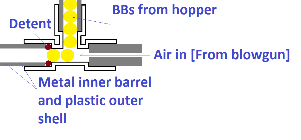

What about this JSR?

Pneumaticology wrote:What about this JSR?
that could work but wont be very powerful because the next bb will block all the flow.
