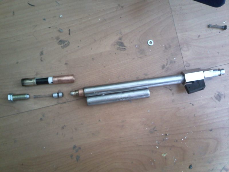

Well now I have finished a concept prototype, full automatic re-cock :)
But it doesn´t work as I thought :( probably because the low flow of the tyre valve, the air that´s coming out is very weak, and the strick-recock cycle is too fast, the air comes out almost continually :? not like da-da-da
Anyway, here is a pic of the prototype, any tips welcome :)
LovableAirGuns
Posts: 267
Joined: Tue Sep 28, 2010 5:58 am
Pretty good for a prototype but surely soon it would be one of the most awesome guns on spud files when you get it working :)
