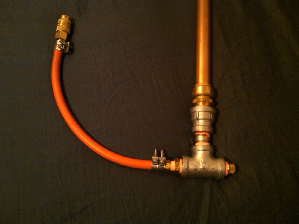

I was making a pump and was wondering how badly the dead space would impact performance? It is currently in a working state but not complete enough to do pressure tests..
I also need a way to make a check valve, I currently have a washer screwed into the threads of the T and epoxied as well as the coupling epoxied and screw tight into it. I was thinking maybe a bolt on a spring with one of those rubber grommet nuts on the end that meets up with the washer?

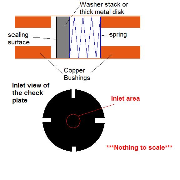

You could probably make a check valve with some copper fittings. A 1/2''-1/4'' copper bushing put in backwards after being polished should work. Just put in a washer stack with a sealing surface on it and a groove cut to let the air flow past the washers better. Just make sure not to cut too far so that the face seals.
check valve.JPG (31.91 KiB) Viewed 7783 times
