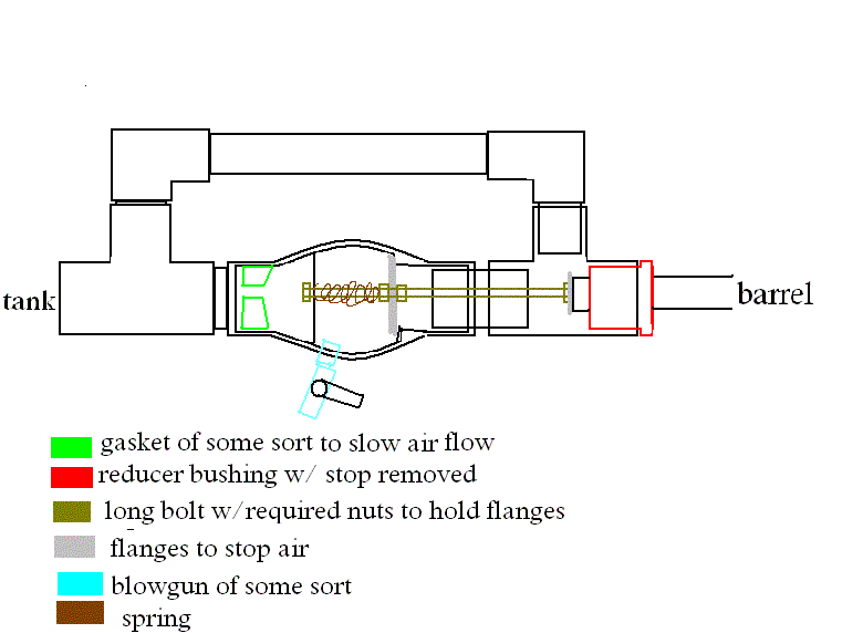

ok. im sick of wanting a supah valve but i just dont have the money. i came up with this. its pretty simple. im not sure if it would work though. it uses a check valve in the middle and well the rest i think is pretty self explanatory.

it is the same as a barrel sealing piston valve, but i think it would fire very fast, good work, and a check valve would help greatly with the effeciency
Hav fun getting that to seal on both points. That looks really unstable. I think you should go with a regular barrel sealing piston because this looks iffy.
I give you props on trying something new though.

That that's a nice one for theory... but I can tell you now, like Gort said, you'd be a very lucky man to get that to seal...

Your valve theory would be good, but it's really too complex when you can get the same power from a simple barrel sealing piston valve...
