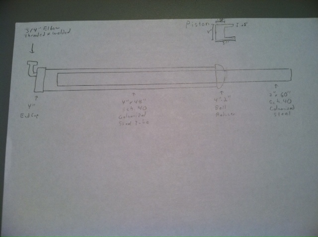

Wanted to get some experienced spudders thoughts on my design. After posting some questions on here I have a pretty good idea of how my cannon will look and wanted to get some feedback.
Will be a coaxial piston cannon with a 4" x 48" Schedule 40 galvanized steel chamber. Using a 4"-2" reducer at top of chamber to taper down to fit 2" barrel. I will have the option to add to the barrel length since I threaded the ends but will be 55" long initially.
I will use this valve to vent the pilot chamber.
http://store.gaugemagazine.com/34gc450x ... valve.aspx
The piston is going to be made of UHMW and be 3.9" diameter and be 3" long. I'm using 1/2" thick neoprene sheet on end of piston to seal barrel. Thanks again to all the posts for info on this and just wanted to get some feedback before putting it together.

Co-axials require some less then standard parts. A standard reducer will not allow the barrel to extend into the chamber to make it a co-axial gun.Will be a coaxial piston cannon with a 4" x 48" Schedule 40 galvanized steel chamber. Using a 4"-2" reducer at top of chamber to taper down to fit 2" barrel. I will have the option to add to the barrel length since I threaded the ends but will be 55" long initially
Maybe get some diagrams drawn, a picture's worth a thousand words
I love lamp
I am having a machine shop bore out the reducer and weld it to the pipe, probably should have put that in the post. Don't have ability to do a pic now lockednloaded. Matty the valve I linked to will only be a valve to realease pressure in pilot chamber. The gun will be a coaxial piston gun, figured this valve would be large enough and allow me to fire remotely.[/img]

That sounds like a beefy cannon. Does the piston just fit in the chamber ID and press against the barrel toward the back of the cannon? That could be a good hybrid design also. You might be building a hybrid and just don't know it!
Moonbogg, I don't have the ability to post a pic right now but I followed the diagram for coaxials on the sticky titled piston valves explained. The piston will seal against the barrel when pressurized and slide back 1.5" when exhaust valve is released. Would be cool if had capability to be a hybrid. This is my first cannon so still learning. Is more of a mortar due to it's size.

Tell us your problems with the pictures, most people can help with computer stuff around here.Atattack wrote:Moonbogg, I don't have the ability to post a pic right now but I followed the diagram for coaxials on the sticky titled piston valves explained. The piston will seal against the barrel when pressurized and slide back 1.5" when exhaust valve is released. Would be cool if had capability to be a hybrid. This is my first cannon so still learning. Is more of a mortar due to it's size.
I know valve is expensive. But wanted valve with 400 plus psi rating. May have been others with similar psi cheaper I just didn't find em.
The piston ideally doesn't need to retract more then 1/2" by the d/4 rule, but I'd at least shorten your travel to 1"
I love lamp
This is a very rough sketch, the elbow on the back of the end cap is 3/4" and I am going to add another elbow to that so it basically makes a 180 and runs up the chamber where I will have the valve to fill it up, a pressure gauge, and also the solenoid valve to release it. Thanks for the rule on d/4. Was unaware of that rule, good to know.
Also, I changed the design on the piston from a cup to a solid cylinder due to the end cap and reducing the amount the piston will travel, hard to explain but figured if I put a big pad on end cap for piston to bounce off of this would help out.
