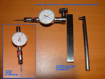

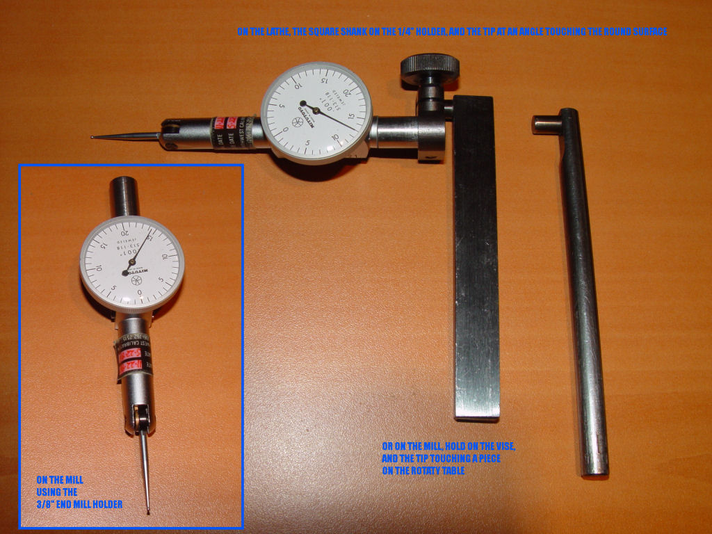

dial indicator for mill alignment

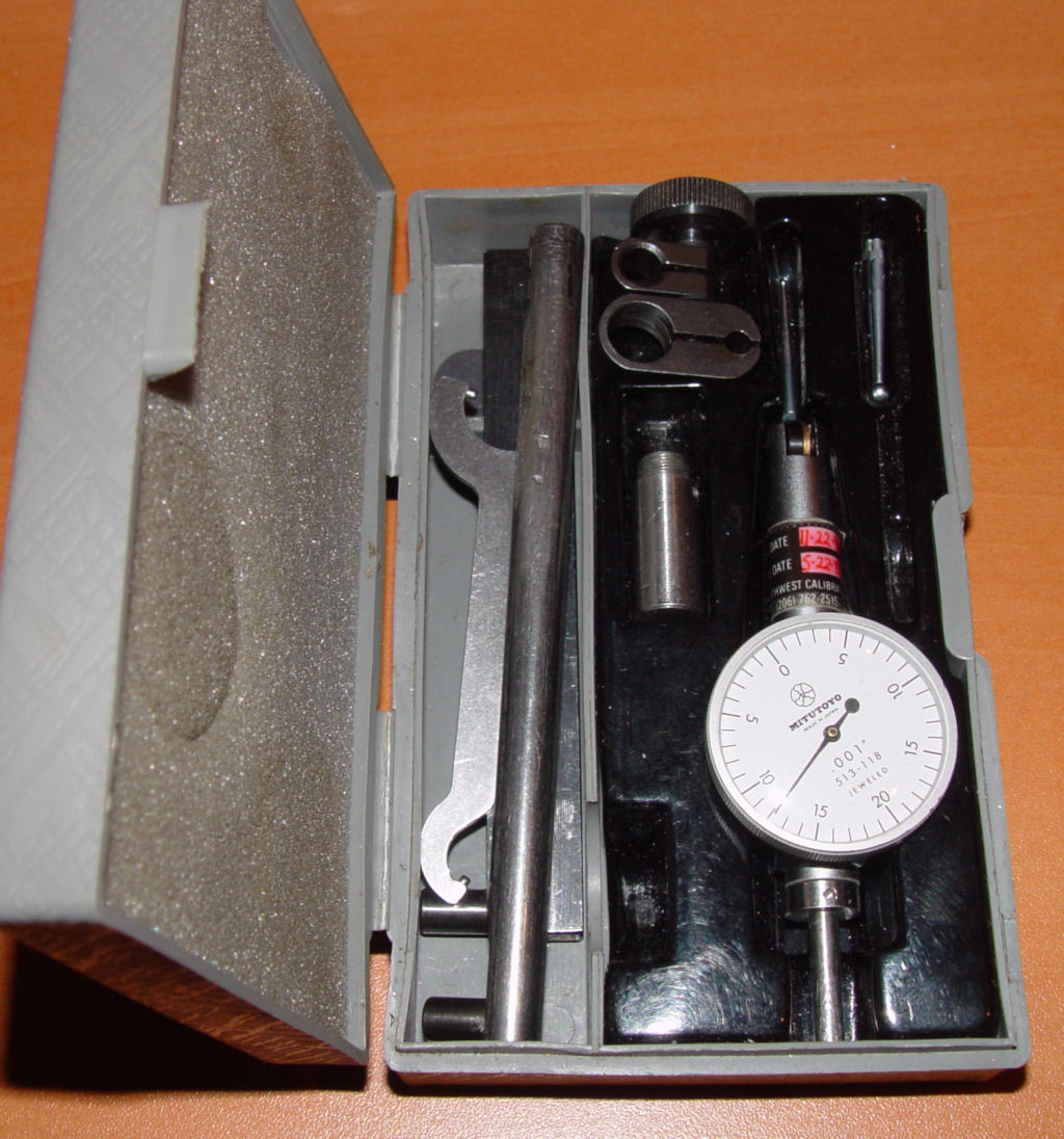

I also would be curious about how to attach this indicator using its dovetails.
Mine is a different model, but I do have various bars to attach it at angles.
I'm not sure how this one could attach for various purposes without those extension bars.
I HAZ A BANG!
Im by no means an accomplished machinist but that should work quite well for you, the only thing is the travel is quite short just .03 of an inch, however you dont need to use all the travel just to get an idea of which way you need to go.
One thing to look out for is mounting systems, many I see are magnetic which are great for the large cast iron lathes and mill tables, but with sherline lots of it are aluminium so youll probably need something that clamps or screws into the t-slots. And when buying used or cheap dial indicators sometimes the mount will cost as much or more if you dont make it yourself.

I use http://www.harborfreight.com/1-inch-tra ... r-623.html and http://www.harborfreight.com/multiposit ... -5645.html with great success.
Edit: I forgot to mention to rotate your machine by hand when checking even a small pull is noticed in the gauge needle...
Once you get a set up and get the feel for using it, it gets easy to do.

Yep, it's just under 1"...This might be to big for your spindle
I use http://www.harborfreight.com/1-inch-tra ... ndicator-6 23.html and http://www.harborfreight.com/multiposit ... ith-fine-a djustment-5645.html with great success.

In that case, you could delete the spindle clamp and insert the round rod directly into a collet. IIRC, the rod is about .375" dia. If the rod dia is to large to fit in a collet, you can turn it on your lathe.Yep, it's just under 1"...
I thought the dial indicator as you use jrrdw are more for comparing height or repetitive sizes, and the dial test are for alignment purposes. I guess you can do both, but I would think the dial test indicator is more useful for the purpose of aligning / squaring a mill column, of checking a concentricity in the lathe.I use http://www.harborfreight.com/1-inch-tra ... ndicator-6 23.html and http://www.harborfreight.com/multiposit ... ith-fine-a djustment-5645.html with great success.
But maybe I'm wrong
