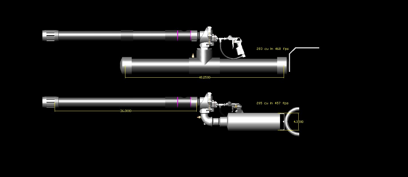

Matty;
Here is a comparison of my launcher versus a 3 inch PVC SCH80 chamber.
Both have 36 inch breech loading barrel.
That is why I stated in PM to use a fire extinquisher. Much cleaner and ergonomic.

wow, looks great, to say the least!! I like the idea that the shorter steel barrel is stronger, however I just like the looks of the longer barrel more for some reason. Thanks again for doing this sketch for me! 8) 8) 8)
Go Bruins!!!!
Do you mean steel chamber?
You like the looks of the bottom model better than the top, correct?
I can put a longer barrel on if you like. 48 inches instead of 36.
With too long of barrel it just looks out of proportion.

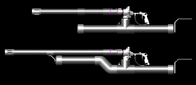

No I like the top one actually. You have already gone above and beyond with the sketches. I wouldnt feel right asking for anything else. Thanks again!!dewey-1 wrote:Do you mean steel chamber?
Go Bruins!!!!

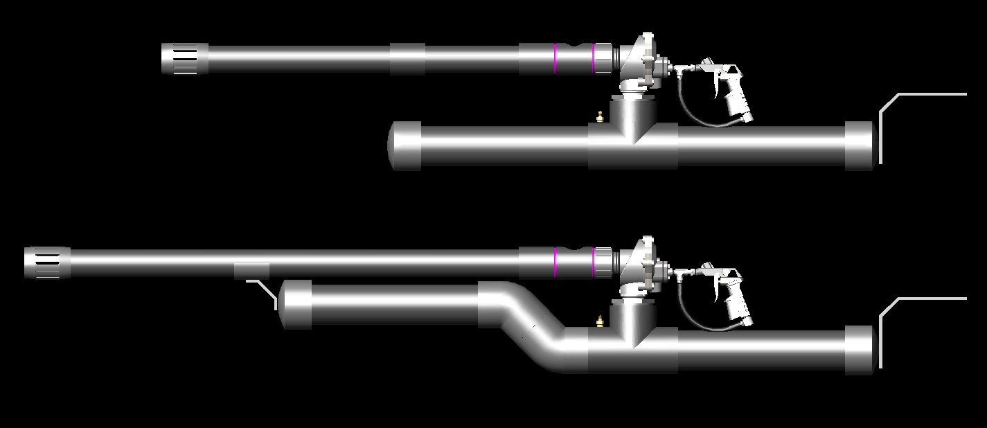

Matty;
Here is another variation with 4 foot barrel that I think you will like even more!

hey dewey the new botton one looks awesome, think I am going to go with that!!!!
