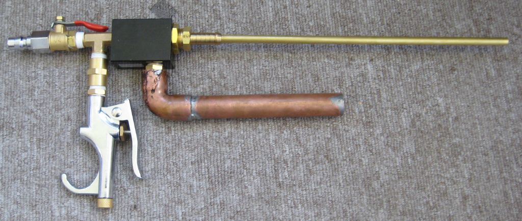

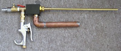

Hi all,
I seen these valves in another thread and just had to have a go.
(http://www.spudfiles.com/forums/ebay-pn ... 23241.html)
This is what I came up with using parts lying around. 7mm OD barrel with 6mm ID.
I have made a separate tank using 2" pipe, 80cm long connected to a cheap regulator. I charge the tank to 115psi with the reg set to 90psi. I get about 15-20 shots before the pressure starts to drop below 90.
I diddnt really do any calculations on it, just started throwing everything together.
Love to hear any thoughts or comments on this.
Cheers
Hrawk
My first QEV

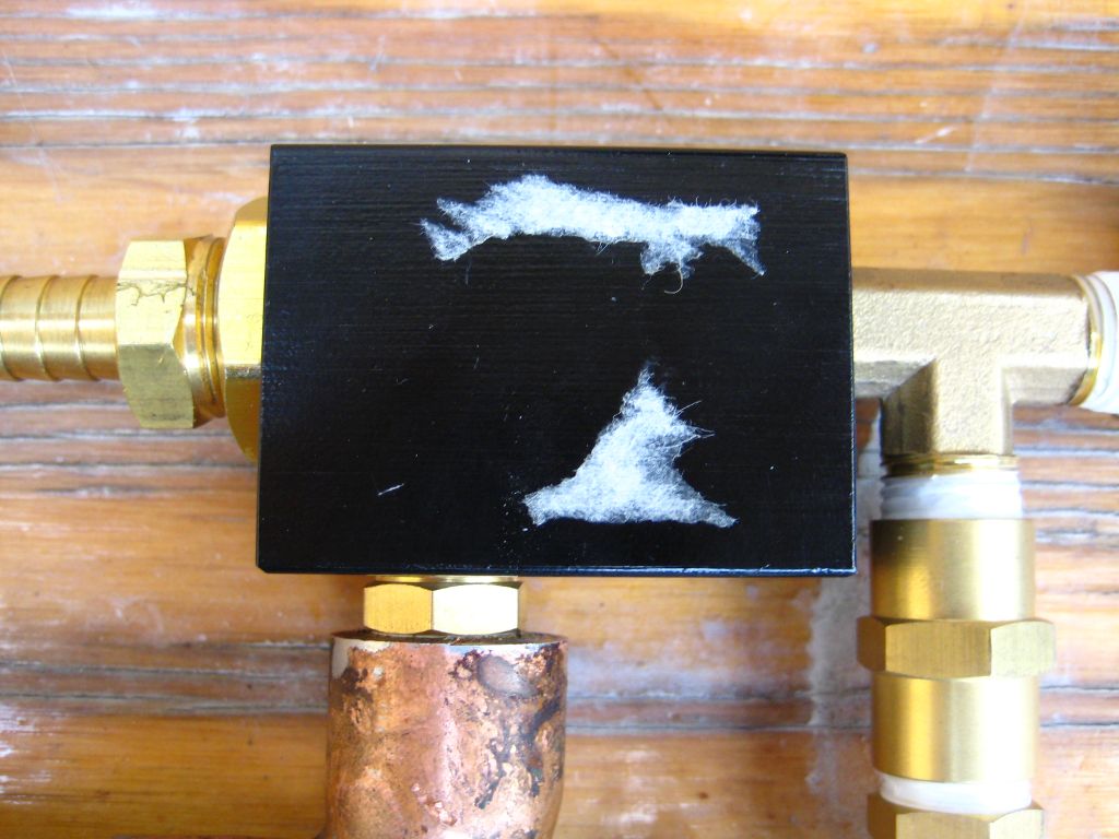

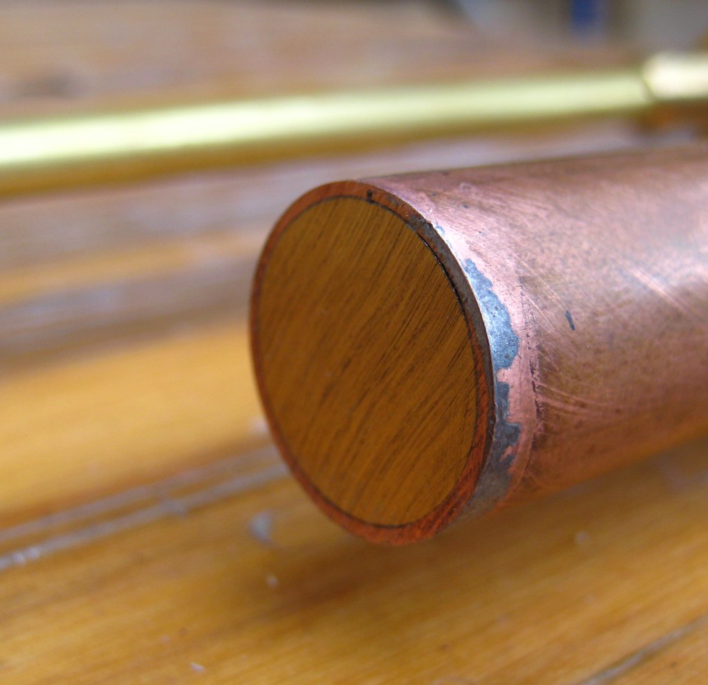

im confused, because i dont see an end cap on your chamber.... and how is the chamber connected to the QEV?
I found that the brass end caps for the smaller size tubing fit perfectly inside this size tubing. I soldered them in place.
At the QEV end, I drilled and tapped for 1/4" BSPT and used a male-male connector into the QEV.

Be carefull, your end plug is waiting to blow off.
you can solder copper. but brass must be brazed.
Brazing requires much hotter temperatures, and a different type of solder.
Copper to brass "solder" joints seem like a bad day waiting to happen.
EDIT:
Although, you are only shooting this at 90 psi.... i would still consider soldering a proper copper end cap... just leave the brass plug there... and put the new end cap over it.
EDIT:

@ Jhalek90 - Thankyou for the advice. Much appreciated. Do you think I could get away with drilling it through and placing a pin through the cap and tube ? It's no problem putting a cap on, I was just trying to keep it neat.

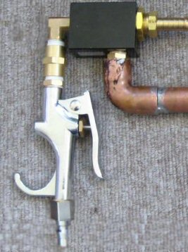

You can fill through the blowgun, thus eliminating the ball valve, this will cut down on dead space and improve performance, as well as making it simpler and lighter.
- qevmod.JPG (25.37 KiB) Viewed 11212 times

What you'd need to do is hold the blowgun open while filling, let go, remove the air source then fire.Hrawk wrote:Hmmm just a thought, If I was to fill through the blowgun, I'm guessing I would need to remove the air source before firing ?
I'm very happy with the way it works so far, turn the ball valve to charge, fire, rince, repeat.
If you're interested in true semi-auto while connected to your air source, replace the ball valve/blowgun setup with a slide valve - it automatically shuts off the air supply and pilots the valve every time it's pulled.

Depending on the type of blowgun you have, it might leak if you fill it through the blowgun. i suggest you test this and if it doesn't leak, scrap the ball valve as jsr said
