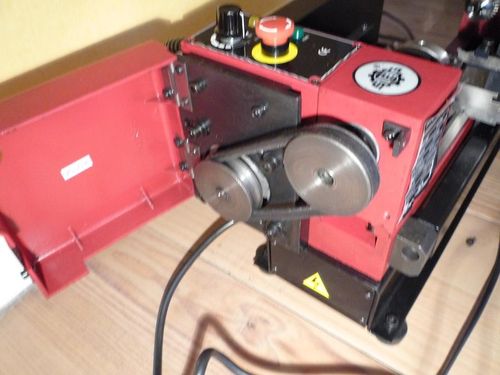

3.) I sometimes get a fairly nasty shock when I have the lathe running and my hand is touching the variable speed control knob, despite it being made of plastic, any thoughts?
Stop using it immediately and have it checked out by a competent electrician. It could be down to static buildup due to friction, but I wouldn't risk it.

Also as a sidenote, this electrocution is not while im cutting or grinding, just as the machine is spinning the work piece.
Is the drive belt rubbing against the body?
Il check in a minute, I can run the lathe with the cover off right?

The belt had bits of rubber still attached to it where it had been cut, so Ive shaved those off and I don't get electrocuted any more! :D

Alster370 wrote:The belt had bits of rubber still attached to it where it had been cut, so Ive shaved those off and I don't get electrocuted any more! :D
Told you so ;)
