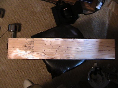

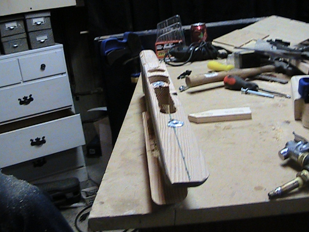

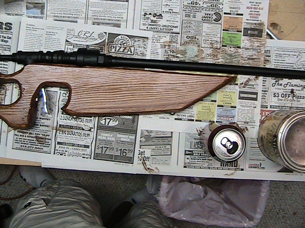

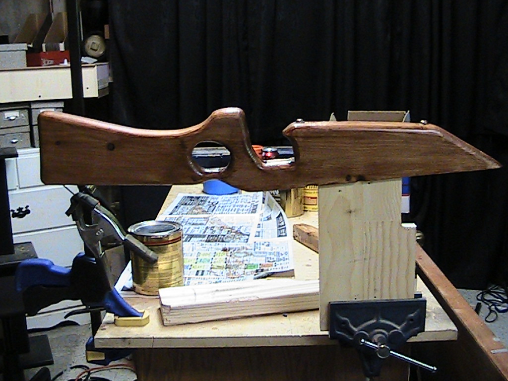

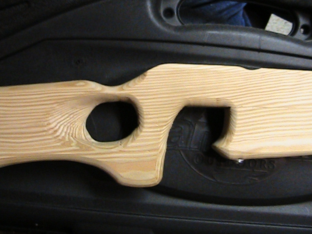

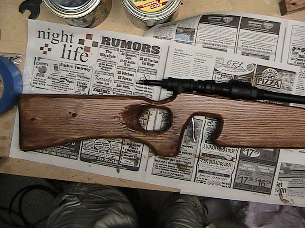

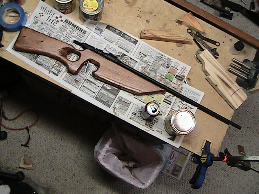

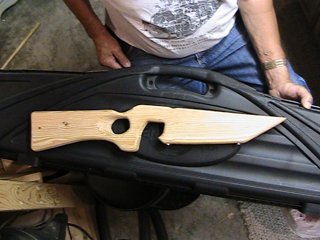

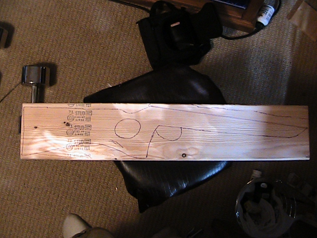

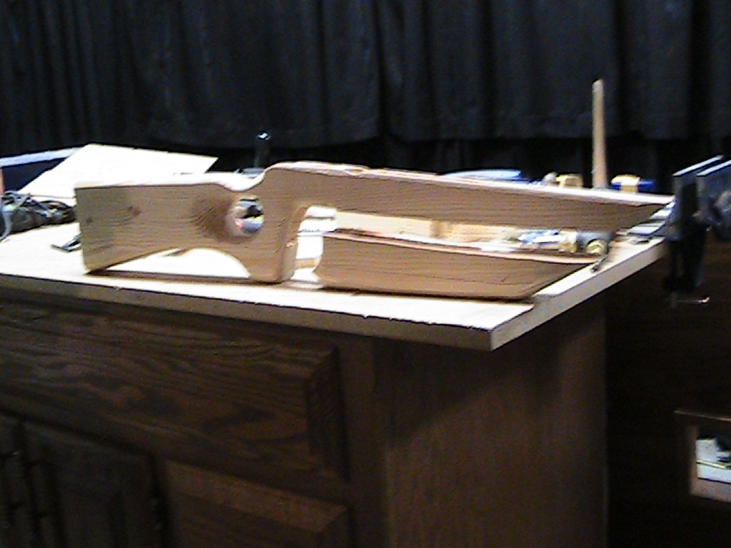

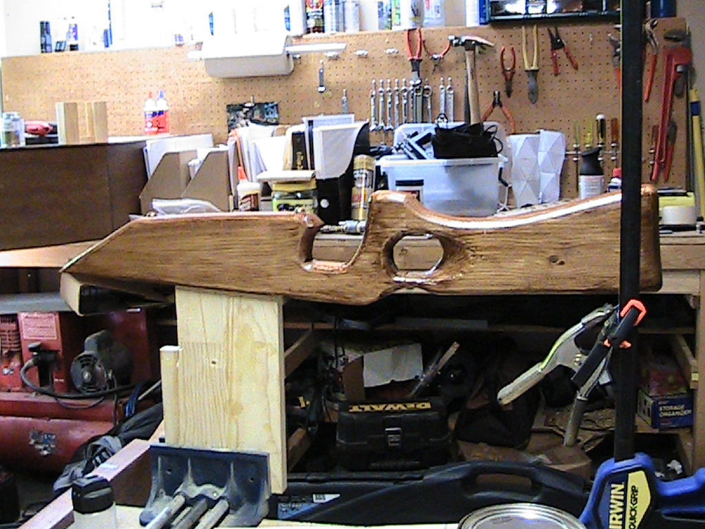

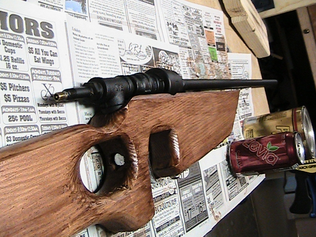

this gun was built for accuracy before power but i am very satisfied with it so far. one major mistake i made was that i built the stock before the gun so there were some problems with that. the stock is made from a 2X10 of douglas fir. the stock was first based off of a single shot .22 i owned, i then decided it needed a pistol grip so i traced an l96 pistol grip and thumbhole. i later decided that it looked kind of whimpy and also the airtank would stick out the bottom so i added a much more beefy looking front grip and secured it with t-nuts. i attached it very well and it looks like one piece of wood. the stock was hollowed out by drilling large holes and then smoothing them out with a smaller drill bit. all of the cutting was done with a skill-saw. after carving out the stock i used wood chisels to make the thumbhole more comfortable. i then used a router to smooth the edges and used a belt sander to smooth the sides more too. it was then stained with an antique walnut finish and then a coat of poly.
the barrel is 1/2 inch copper which is working very well for me. i was originally going to make a .22 barrel for it with a nylon bolt but i dont think i will do that. with the 1/2 inch barrel it is still extremely accurate with no sights at 25m. i purchased a shock pump and have shot it at 250psi and it is very very strong and accurate. the trigger mechanism is probably its worst part for the pilot volume is too big but it is filled with a shreader soldered into place and is piloted by a blowgun

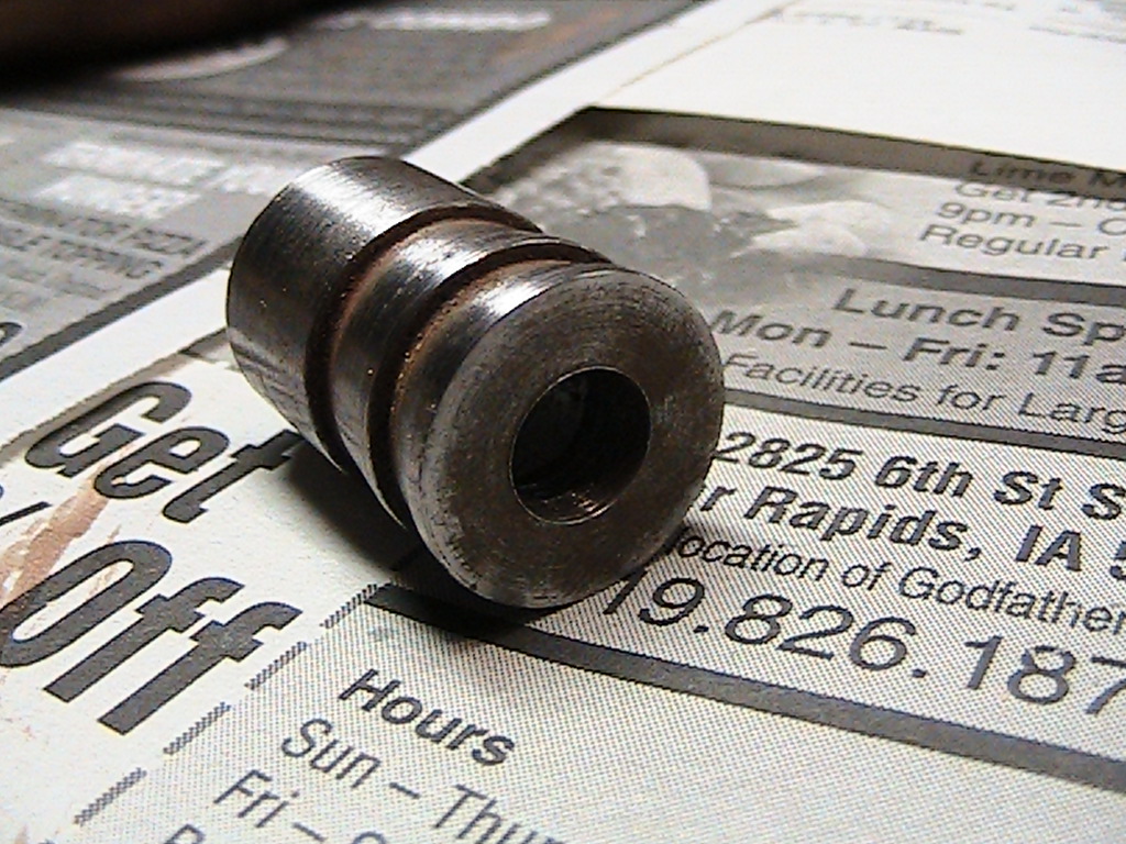

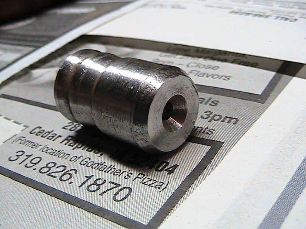

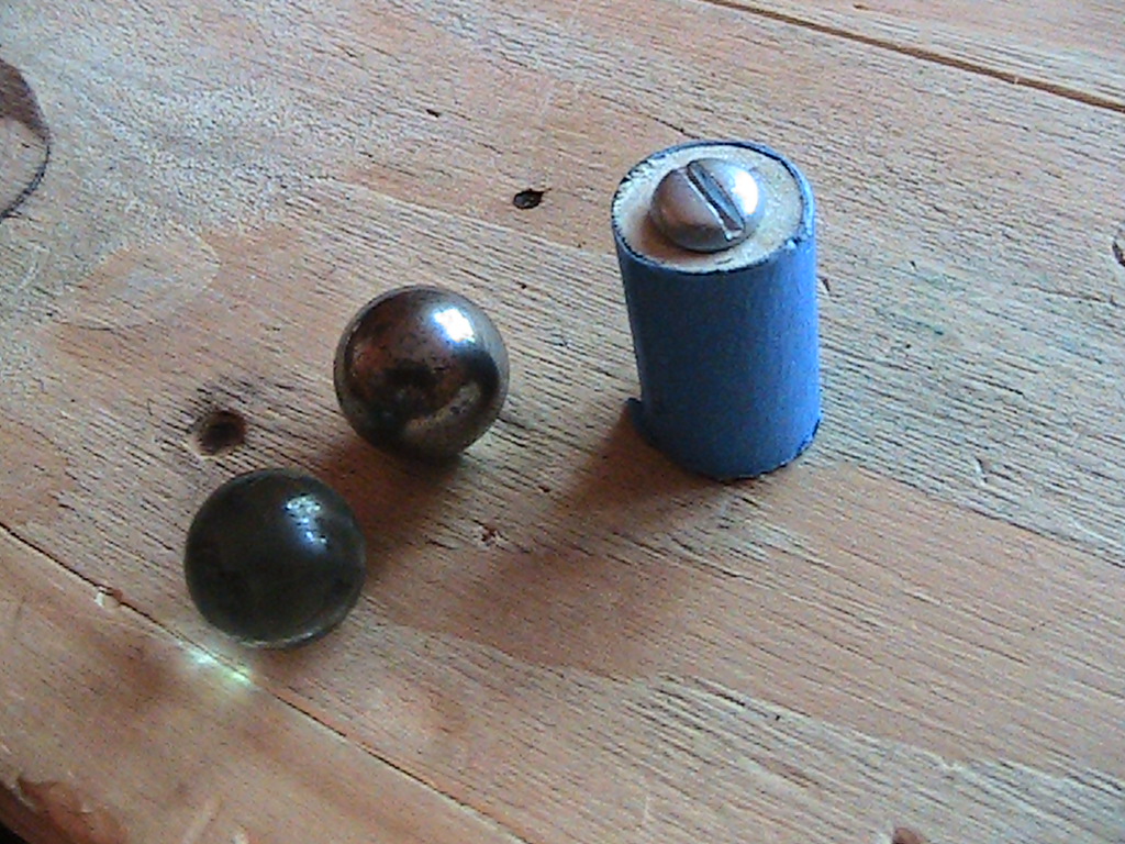

main ammo: wooden dowels with screws at tip. marbles. steel balls. steel or aluminim bullets
i hope you like it bc i really do and i hope to make more guns with stocks
1/2 qev rifle with stock!

really nice stock, in compare the gun need to be better(semi auto etc.)
but looks good very clean:)

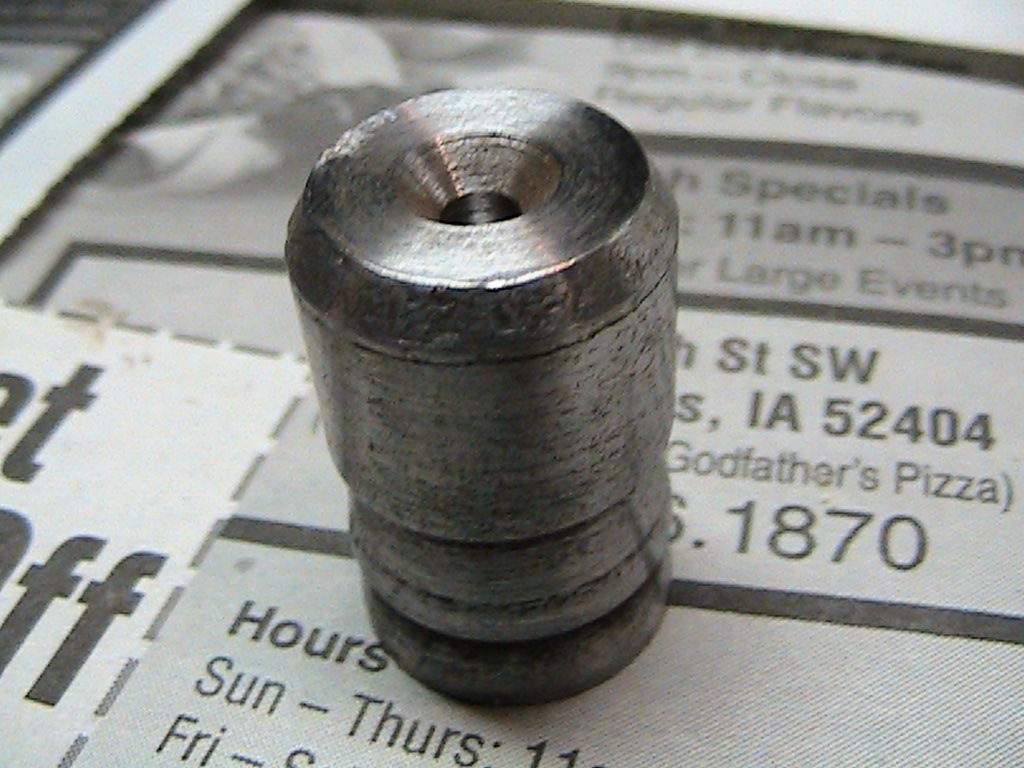

Only negative comment is that those projectiles you call bullets are probably tumbling like crazy, being that they're nearly symmetrical front/back.

Very nice gun. Congrats! I wish I had a workshop and tools like yours to work with. As opposed to the other posts, I like the beefy stock, especially since you could loop the air tank into the new hand grip to give it more air volume if you wanted to.
Are you planning on putting sites on it or will it be a point-shoot kind of gun?

the back is hollowed out so they are front heavy and fly striaghtsaefroch wrote:Me likey!
i was planning to but it looked far too ugly. with no sights i can hit a 3X3 target at 25m so i think im gooddanielrowell wrote:Very nice gun. Congrats! I wish I had a workshop and tools like yours to work with. As opposed to the other posts, I like the beefy stock, especially since you could loop the air tank into the new hand grip to give it more air volume if you wanted to.
