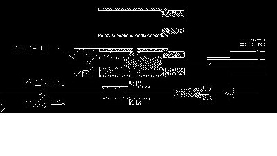

Have been working on this for a little while now. Think I've about got it figured out, but "a fresh pair of eyes" may see something I'm missing.
Overall design layout is similar to the Air Force rifles, with the striker being propelled toward the rear.
It's knock to crack/blow open with the step on the spool (hopefully) providing a degree of self regulation similar to that found in typical poppet valves (hammer valves). A spring can be added to aid in regulation should that be found necessary.
The rear block (seen on the left) is to be threaded to accept paintball type tanks...co2 or regulated hpa. Hopefully length of pull won't become an issue. :roll:
Have yet to decide whether to countersink some more shcs to retain the rear bottle mount block or simply thread it...leaning with threads.
It's not going to be .22 cal. :twisted:

That looks really promising. I assume the screw will hold some kind of sealing?
It doesn't look like there are any flaws in the design, the only weak spot I see is the sealing face and possible blow outs over time.
Considering your experience with your hpa coax, that shouldn't be a problem.

The screw will be a stainless piece and is just there to take the abuse dealt out on the spool by the transfer of energy.
The spool will otherwise be one piece, made from either delrin or nylatron. Been having good luck with machined seats and perimeter sealing valve stems in the pcp builds(nylatron @ 2500-2700psi), so I'm thinking to take advantage of a harder seal for the improvement in performance it offers.
