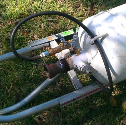

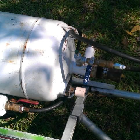

Over the last two days I cut the restrictive valve off the front and welded in a 2" coupling and added a 2" union to open up the air way.
I relocated the blasting cap fitting and the fuel/air input and gauge location to the sides of the cylinder and test fired it tonight at 3X mix.

Here are some pictures of the setup so far.
Umm, you are going to need a bigger outlet from the tank. The flow restriction on that union and pipe will not flow enough volume to make use of over 90% of the chamber volume. That will flow a lot like poping the hose off a compressor. It will blow for several 10's of seconds. Only the first 0.030 of the flow or less will propel the projectile. A chamber 1/20th the size will have about the same performance on that barrel setup.

I also thought about something as I was writing the post earlier about the big spray paint can part.. There is actually a tube that extends from the opening where the barrel would go - alll the way to the bottom/back of the chamber. It's just like the straw in the spray paint can.
That tube will cause all kinds of problems.. from the mixing of the fuel/air and possibly bursting the burst disk before the mixture even ignites and creates any decent amount of pressure in the chamber..
So I relocated the detonator port to the side of the chamber - which I discovered is about 1/4" thick! I welded the port, and welded a 3/4" x 1/4" bushing in its original position that I will use for another gauge.
Going by what you have said and how the whole setup works when I fire it. I may cut the valve completely off the top/front and weld it up to the bottom/back of the chamber and weld in a 2" union up front for the barrel.. That should flow very well.
