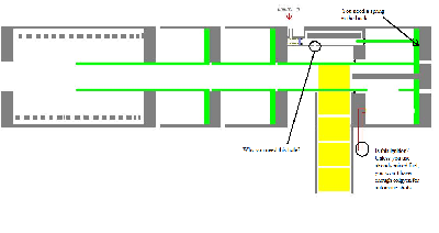

hi tell me what you think please. will this work?
i edit an new version

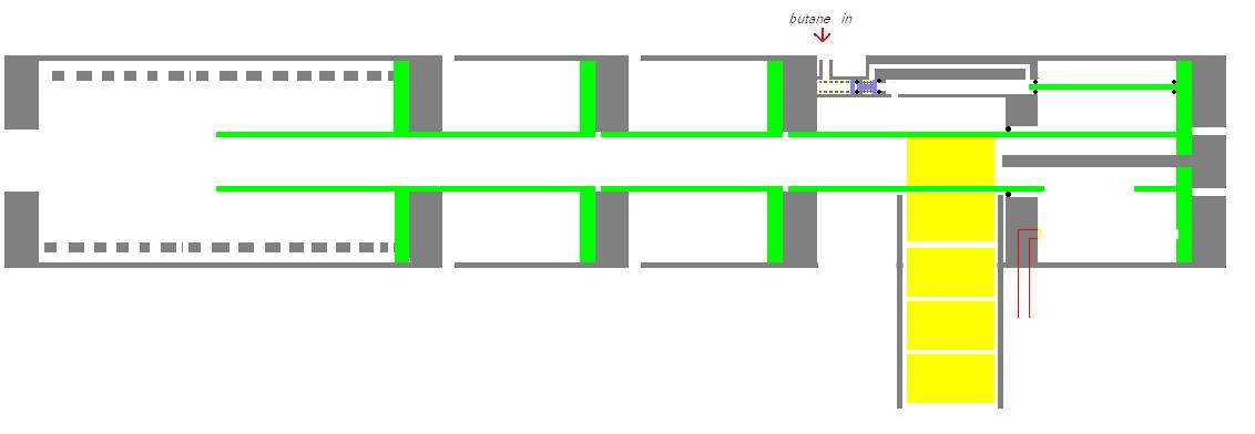

Lol I didn't understand your diagram, but even through that it won't work, first the "butane in "port won't allow any butane in,probably you draw the one way valve in the wrong direction. The rest of o-rings I don't understand any of them, I don't see how the reload mechanism work either.

well the checkvalve is actually a hammer valve.
the greenpart is the moving part.
the orings are glued to the green part.

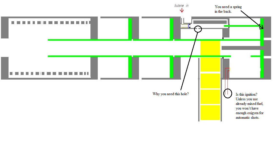

This is what I have understand so far:

ok i am try to describe (ah i missed one green disk in my diagram i edit that)
before you do the first shoot you have to cock the green part (to the left side)
ok
step 1
-the green disk number 1 (right to left) displace the air in the chamber through the gap between the barrel (also green) and the second grey disk
the holes in the first grey disk allow air come in and out so the green part doesn't suck adhere)
-load new ammo
-the thin piston reach the valve and let the butane behind the second small o-ring and stay because the hole (you ask) at atmospheric pressure
-the first small o-ring is to doesn't allow butane reach the chamber
-the big (left) spring is compressed
step 2
-the compressed spring push the green part back
-the chamber fills up with fresh air through the gap
-the small piston push metered butane in the chamber
(now i also added a little thing to the diagram)
step 3
-fire the spark
-the bb/ammo goes forward and left the small holes in the barrle
-the combustion gasses reaches the second and third chamber alias cylinder and pushes the complete green part against the sping and the cycle can begin new
