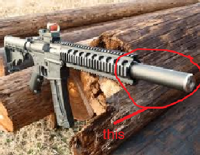

i weighed the nylon and some carbon fiber i had (alot more than that tube)
and it only weighs 423 grams which is very light
And i like the look of thick black nylon looks like an integral suppressor.
