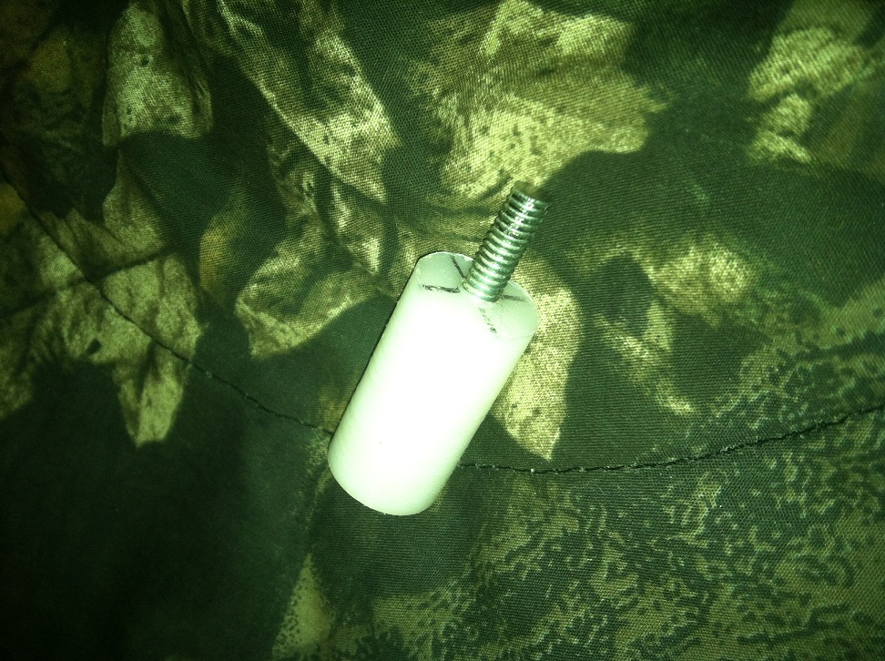

The piston isn't done, I haven't gotten the o-ring yet so I haven't machined the groove, but the piston was machined via Technicians how to located here- http://www.spudfiles.com/forums/tutoria ... 21740.html

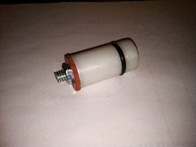

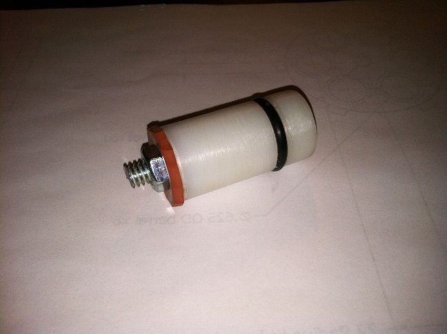

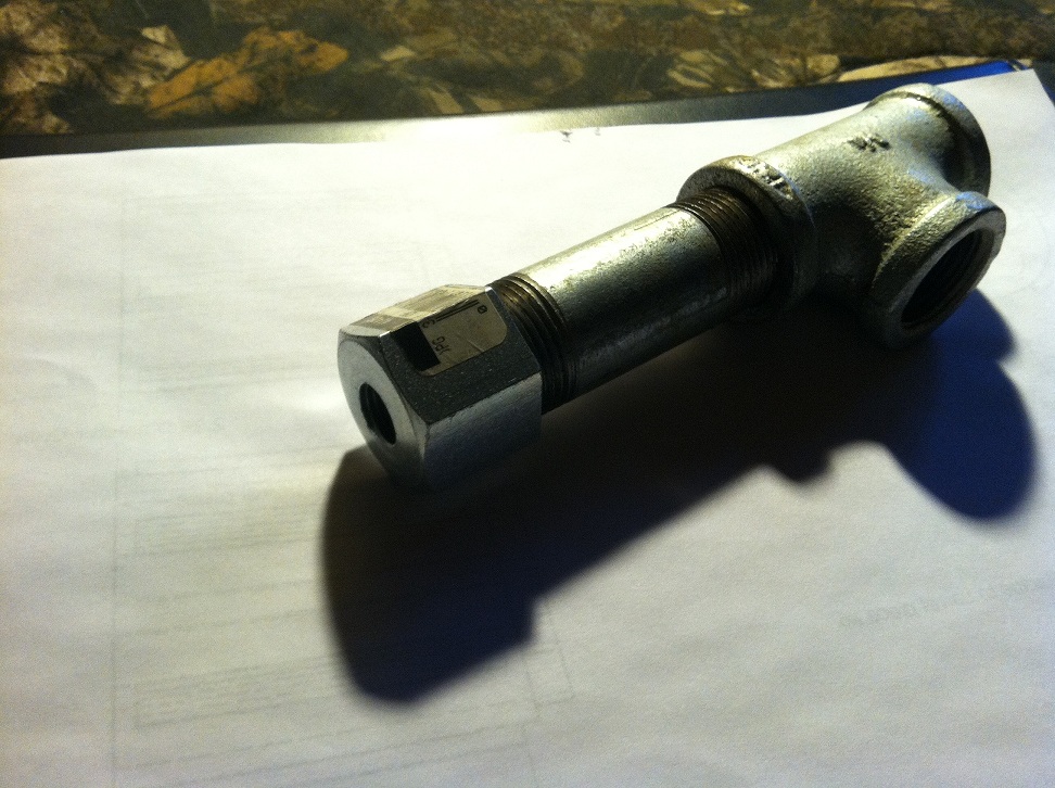

Ok did alot of work today.
Finished the piston and put the o-ring in it, fitted a sealing face to it, and found some AWESOME endcaps that have a FLAT surface which makes drilling and tapping holes alot easier.
The piston housing is a 3/4" nipple, and has a smooth inside so there is no weld seam.
Gonna glue the nut to the bolt so theres no leakage potential, and i'm actually a little worried the piston may be a PERFECT 100% seal, so i may have to add a hole through the piston so the chamber can fill.
Gonna rep Technician's tutorial again here- works like a charm, and its SUPER easy and makes a very professional looking piston.
Tomorrow I'm hoping to fully assemble the valve, add a test chamber, and add the sealing face for the piston.
You won't actually see this gun fully assembled for a couple weeks since most of the parts are being shipped to my college house.

Looks like there is not washer on the sealing face; adding a small one might help, if you can fit one. Not sure on your seat diameter.
the nut is practically a washer, the barrel ID is .5 something inches, and the nut fits perfectly in it with almost no room to spare so i don't think i'll need one.

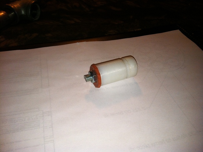

Why not reduce the diameter ahead of the o-ring groove and make it float:JDP12 wrote:i may have to add a hole through the piston so the chamber can fill.
im probably going to, my original plan was for a floating o-ring, however the o-ring i have juuuuust baaaarelly holds itself in the pipe, so i wanted to stretch it a bit. but i might go to a floating o-ring we'll see. I can always go to floating o-ring at any point.
