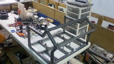

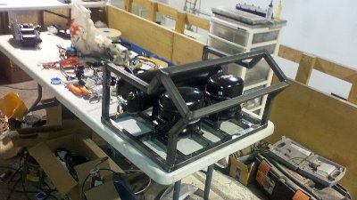

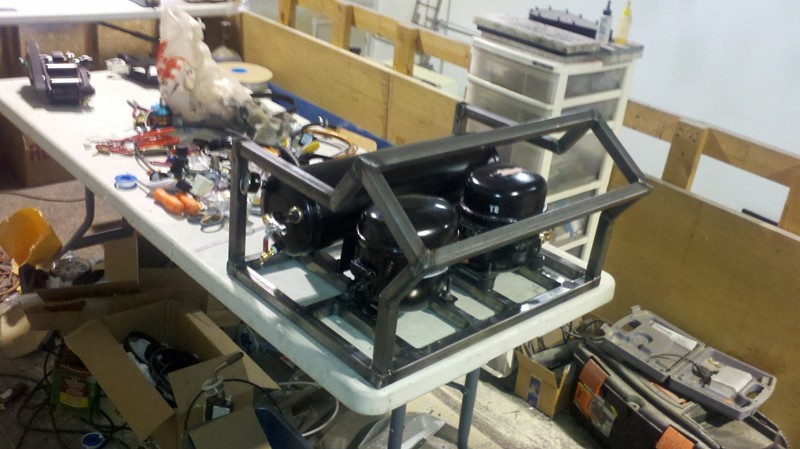

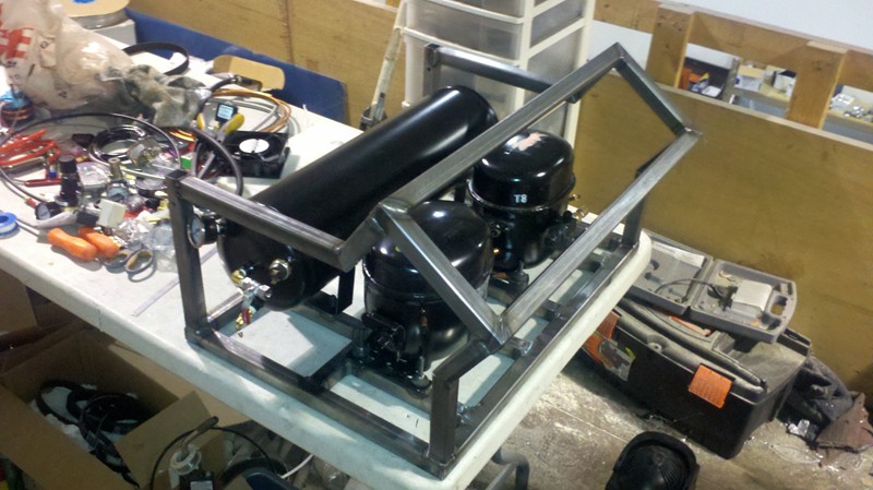

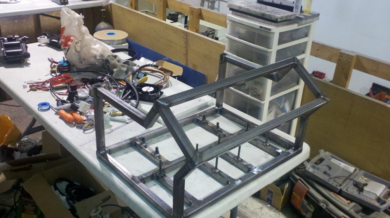

Here are some pictures of the compressor as is sits. I hope to have the framework and all other fabrication finished by the weekend so I can get it to the powder-coater for some color.
The console is, obviously, the protruding rectangle at the front/top. All controls, regulators, switches, guages, and quick disconnects will be located there.
Matt
