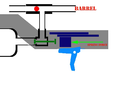

now for the unfinished part, the actual hammer and trigger
for the hammer i wanted to mount a weight(hammer) on a liniar bearing.
i didnt design a trigger mechanism yet, there is where you guys come in ;)

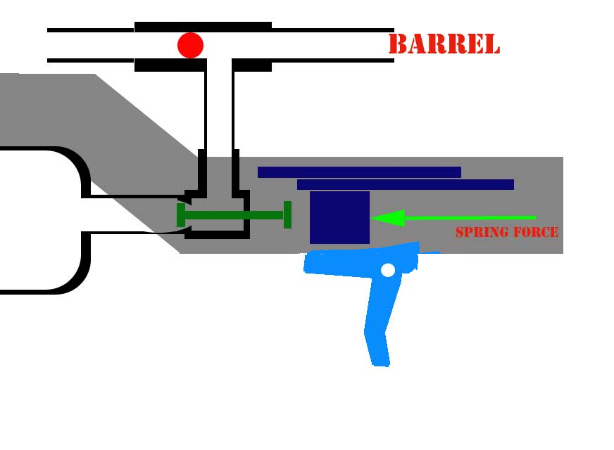

Looking good. I don't really see an advantage of using the slide bearing, but maybe it will be smoother than a tubular hammer because of friction. So I guess it's a nice find.
The trigger should be pretty simple to make. I made a mod to your diagram, so it should be simpler to make.

The secondary lever is necessary to allow the hammer to travel further and get a better swing at the valve pin.

I don't understand :? Just move the one piece trigger if more hammer travel is needed.
Hawkeye
Posts: 462
The idea is to have the trigger in an ergonomic position. You could move it forward but then you're reaching up the forestock to trigger it.
The secondary sear lever is pretty common I think.
Gun Freak
Lieutenant 5
Lieutenant 5
Posts: 4971
The trigger I drew is in the same position as the one he drew.
The secondary lever is only needed when there is a forware traveling striker. Since his is forced backwards, only one piece is needed to release it.
Hawkeye
Posts: 462
Only needed for a forward travelling hammer? Like in the Airforce Condor? lol
Neither of the diagrams look like they have enough hammer travel but the secondary lever at least gives the possibility.
With the short travel and single trigger you're going to need a heavier spring which will make it harder to cock the hammer.
Since it's not THAT much harder to put the second lever in I' would do that to try to make the most balanced efficient system.

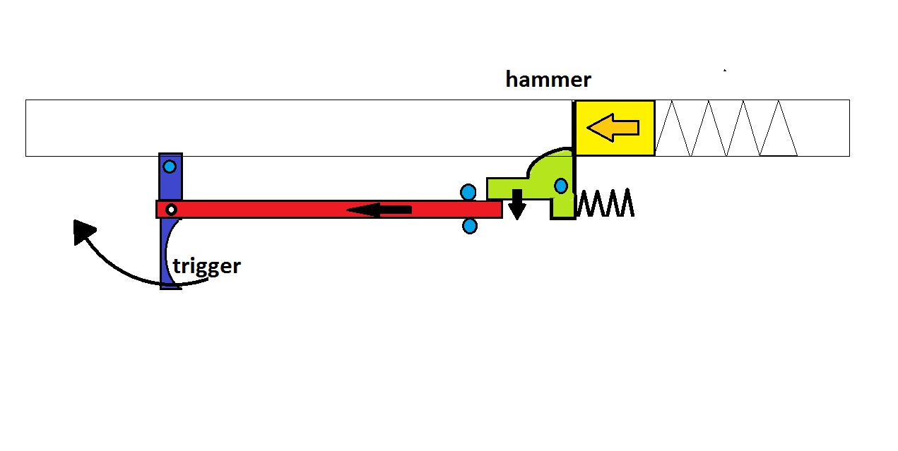

yep, the travel of the hammer is yet to be decided on, but the parts i have do allow for a decent travel if it would be needed.
the trigger position is fixed in my opinion, of coarse it would be possible to adjust it a few centimeters back and forth if its possible to keep things simple.
if i cant get enough travel i need to use the second lever. i just drew it in because i expect it top be neccesary :P
however, tnx for the simpler design, i kinda overlooked the possibility, so i surely will look into simplifying if possible.
my design needs a sligtly heavy hammer, that the main reason i did go for a sliding blok instead of a lighter piece of metal inside a tube.
this type of drawer bearing is use in DIY cnc mini routers, so im sure it wil be up to the task :P the extra weight in this case is not an isseu.
my diagram isnt very accurate however(the aluminium profile is lower), so im not absolutly sure if i`m able to place the trigger underneath the block, it might be needed, to place is to the side of the block, if you know what i mean :)

Something like this?
quark1980
Posts: 55
Joined: Tue Dec 29, 2009 11:50 am
Location: eindhoven
should be perfect... the pullrod can be place to the side of the block.
the green catch would grab into a stud or so on the side of the block so that way i could get it to fit inside the aluminium profile...
the inner side of the profile is 4cm so i should be able to get it to fit :)
