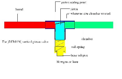

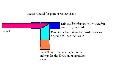

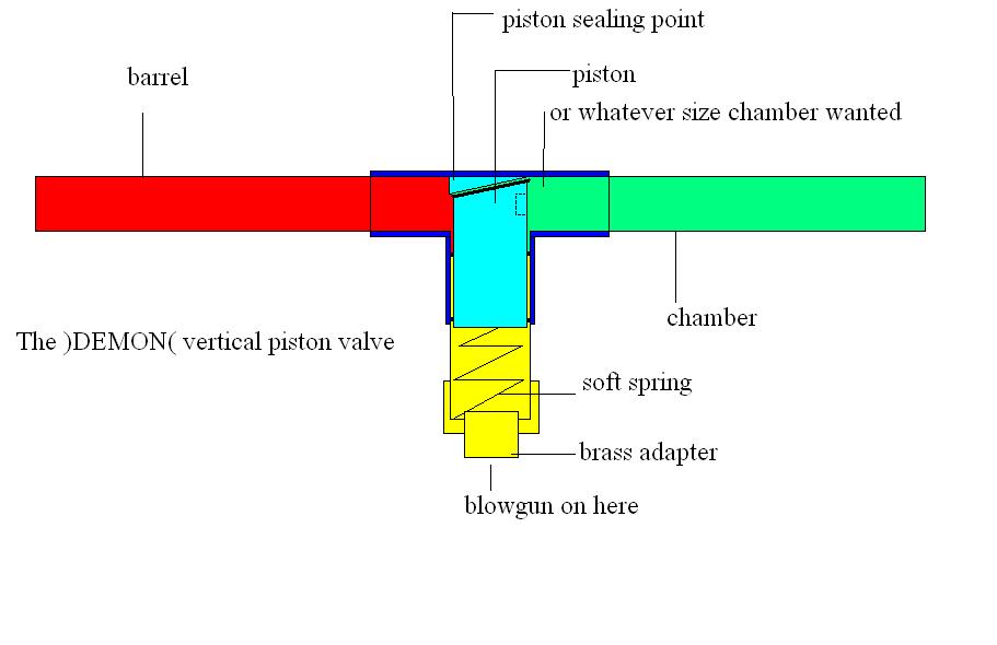

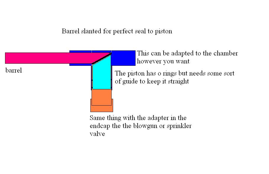

Call me dumb, (please don't), but shouldn't your piston slant be from the lower right to the upper left, so when you release the pilot resavior the presure forces the piston open?
Otherwise i like the idea, and i think a bigger valve could be made this way. Looks like it will open very fast, a straight push to the barrel.
Would'nt the air go right around the piston? There's something almost identical to this on spudtech called the PL3X valve, you can't stop the air from going around a piston.

Maby if you used a snug fitting piece of pipe for a liner, and bored holes in it from chamber to barrel, then fitted a piston in the liner??? Maby?
I now see the problem with getting it to seal just with the tee and piston, they should make a flat inlet so you could use a flat piston.

You could cut the barrel at an angle and have the piston seal against it, basically a barrel sealing valve at an angle. You could also put an elbow on the end, if you can get the elbow in the tee.

How is the air from the chamber going to push the valve open? I know that when you releave the pressure from the pilot chamber the valve opens, but the air from the chamber is sapossed to help by forceing the valve open with the pressure, makeing it fast opening. I'm not saying your idea wont work, it will. It's just that haveing the slants the way you have them in your drawing, it's going to block alot of the air from the chamber by not letting the pressure assist the valve to open, know what i'm trying to say?
