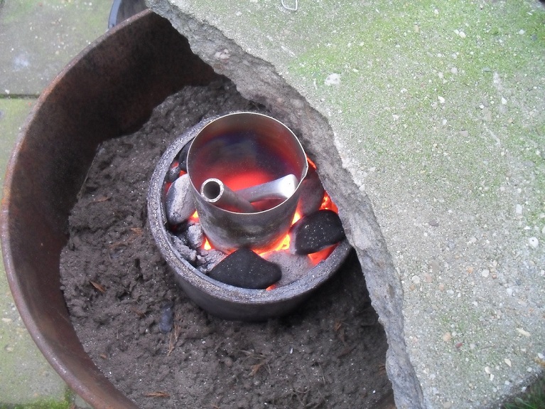

Thanks to youtube ( and after being motivated right here!) I learned how to make a charcoal fournace capable of melting aluminium!!
My Fridgy died on me so I cut off the top and used the shell as the main body of the fournace.
The aluminium plug through wich the wires connected was drilled out to serve as the air intake.
I put it in an old oildrum filled with dirt and put a pipe through it and hooked that up to the motor and fan out of an old paintstrippergun.
I put in the coals and lit her up.

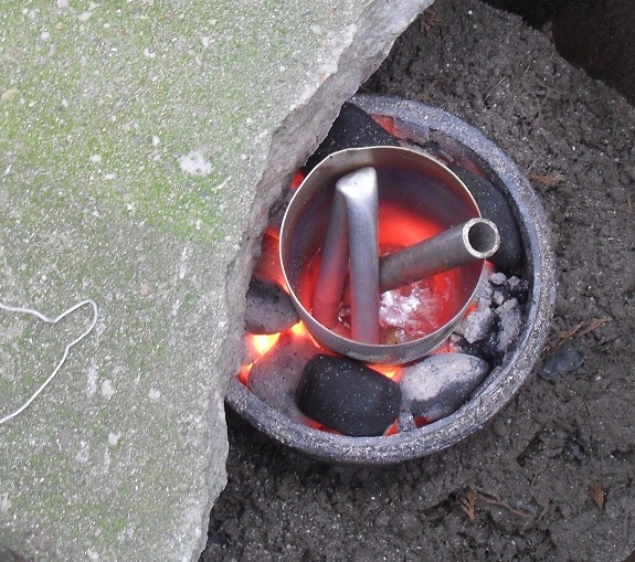

After about an hour I discovered that I needed to put charcoal underneath the crusible aswell...anyway...I took just 2 pictures when the actual melting had begun...I pured some in a pipe..wich failed to give me solid roundbar...the rest became a nice blob looking thing...
This was just the test...
A very succesful one... :D I succesfully metled aluminium and brass...became a pretty good alloy by accident..harder than the aluminium I started out with.
I will now focus on making molds.
The intension is to pour complete gunparts such as breechblocks for wich I would otherwise need a mill.
I can make the part out of candlewax, pour gypsum around it and let it dry.
Afterwards I'll melt out the wax and pour the aluminium in.

Anyway...I have just learned how useful it can be to insulate the fournace.
This will confine the heat to a smaller area..less loss...
I see guys melting aluminium in half the time.
I need concrete...the foamy kind..

Aluminum burns (turns to oxide) which will contaminate the liquid metal. Before pouring, it is recommended to flux the aluminum and scrape off the top layer of slag.
A good flux to use can be obtained from a spa or pool supply outfit. Use a piece of a Chlorine tablet and toss it in just after you turn off the blower. Use your iron skimming tool to push the tablet to the bottom of the crucible so the gas bubbles up through the aluminum. When the tablet is gone, scrape off the slag off the top and it is ready to pour.
Google these terms together for more on the subject.
fluxing aluminum melts

You're going to burn through that crucible pretty quick. Try finding an old
hpa cylinder or a 3" cap/nipple. I think you're going to rather enjoy casting brass. Aluminum Doesn't always cooperate with me though.
Oh by the way, I have a very old cannonball tutorial in the how-to section for this sort of venture. If you haven't already seen it.
I scooped off the slag.
That much I knew.
Next time I'll add a chunk of chlorine tablet as a flux.
Some guy on youtube recommended baking soda.I was originally planning on usingthat when the actual moulds will be cast.
I was worried about that seeing people burn through soupcans..
The crusible is some kind of stainless steel.It's got a thick bottom and has survived 100% intact.As brass needs to be 1250 degrees centigrade to melt and no speck can be seen on it it seems better than expected.
Hard as hell!
As it is pretty thin looking I was expecting a comment.
It will have to do untill I find something better like what you suggested.
I have a disposable CO2 weldingbottle I could use...but I really want to use up that gas first.
