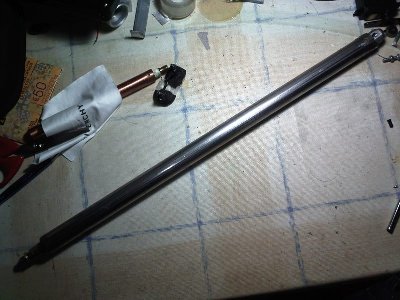

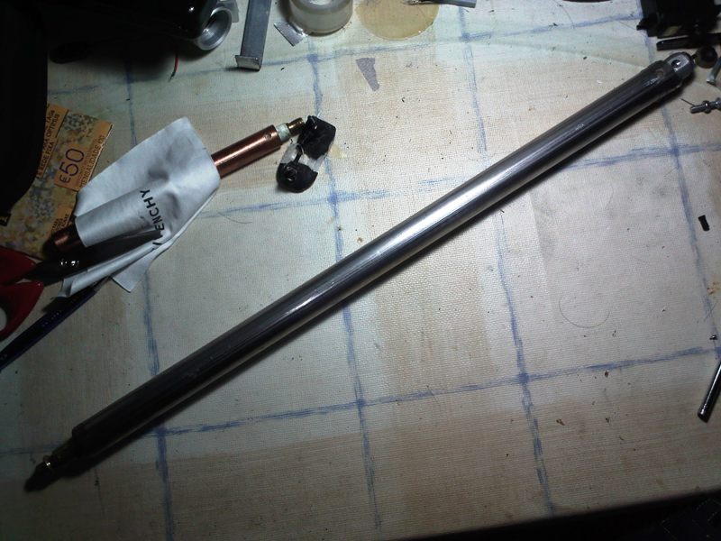

I have started my new pcp project. (BTW Gun Freak hope that´s ok to you :wink: )

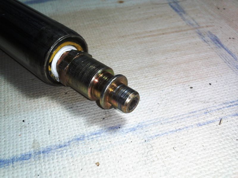

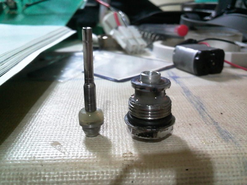

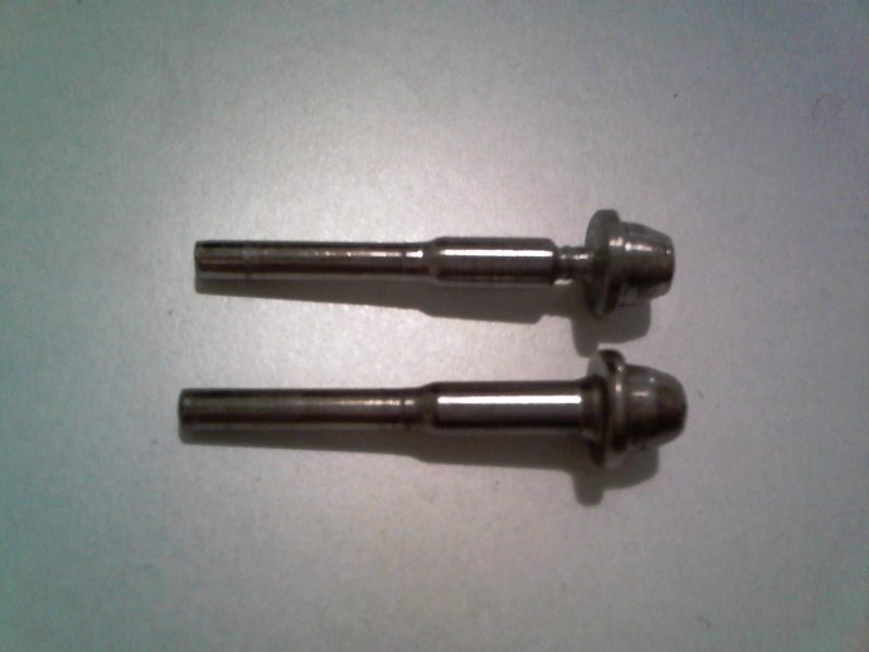

I had did some big modifications to the blowgun valve, replacing the original rubber seal by a harder seal material that are used in co2 pin valves. Now it deals with high pressure with on problem. I have charged ti to 500 psi, left it for 5h, no leaks at all 8) then I checked the valve internals, no damage :D .
The quick connection is a industrial type, build for high pressure, I add a internal one way valve so I don´t need a ball valve, making it light and better looking.
It gives me at least 60 shots :o , after than the pressure drop to about 300, still very ok for airsoft bbs.
It actually hurts a lot if you put your finger near the out put and hammer it, when fully charged :P

Very nice!! Is 500 all you plan on using? Or will you take this one up to 1,000? Video :)

Not sure about 1000, but definitely 800 :wink:

Gonna buy a drillpress this weekend so I can use it like a lathe and machine the hammer(yeap on this gun it´s still going to be a inline striker) and bolt :)

what did you use as the new sealing face for your valve stem?

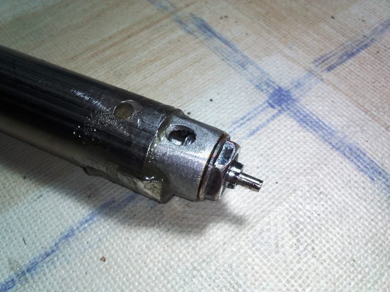

what kind of epoxy you use? is there any name for that type of epoxy? it's strong enough to hold tht much of pressure :) thnks :D

The sealing came from a co2 pin valve pin, about epoxy I used one with 360 bar rated.

The epoxy is rated at 360bar?
Would that be an actual pressure rating...or perhaps...a mechanical property? ie...lap shear strength
Care to name the brand and type?
Well worth careful consideration considering the proximity this piece is going to have to your face. :wink: (yours...not mine...and so is the choice to use it or not)
IMO...it's best to think "if it can fail...then it WILL".
Mechanical, 360 kg/cm2
There is no way to fail, I even have drilled a couple holes so the epoxy can grab.
