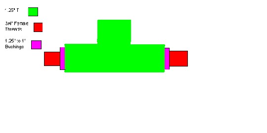

Start with the 3/4\\" plug. Bore out the back with a drill until you can slide a 3/8 coupler into it without screwing it in or anything.
Next, dry fit the bushings, T, and Female Couplers. The 3/4\\" fittings should fit into the 1\\" bushing. If it doesn't fit, sand it until it does. This part is tricky. Glue the bushings onto the opposite sides of the T. Glue the 3/4\\" threads in the bushings. Now pick a side, and put the 3/4\\" plud that you bored out in the back of the threads from the inside. You probalby should have dry fitted this too.

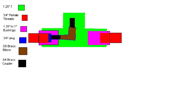

Now comes the brass. Rub sealant all over one end of the coupler and the inside of one end of the elbow. Screw the coupler in before it dries. Now put way too much sealant on the other end of the coupler and stick it through the plug from the inside. Before the sealant dries put globs of sealant through the 3/4\\" female threads that have the plug in them. Now blow through the open end of the elbow to make an air hole in the sealant. ( you can either do this or drill a hole later)
Make sure that the elbow is as centered as possible. Put more sealant inside the elbow and on the other 3/8 coupler and screw in the coupler. Make sure it is centered and not sticking up out of the T. It should look like the second diagram from the outside and the first diagram on the inside.
