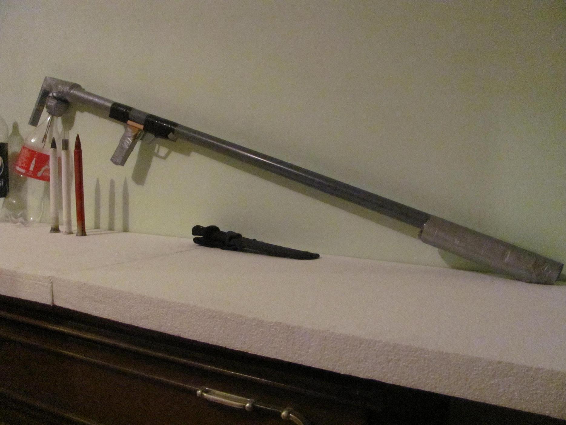

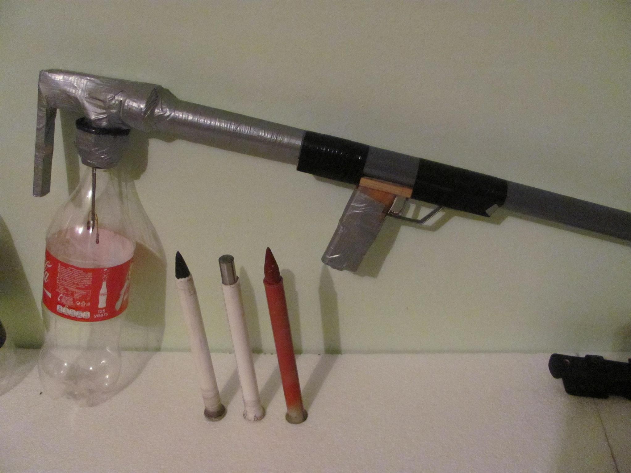

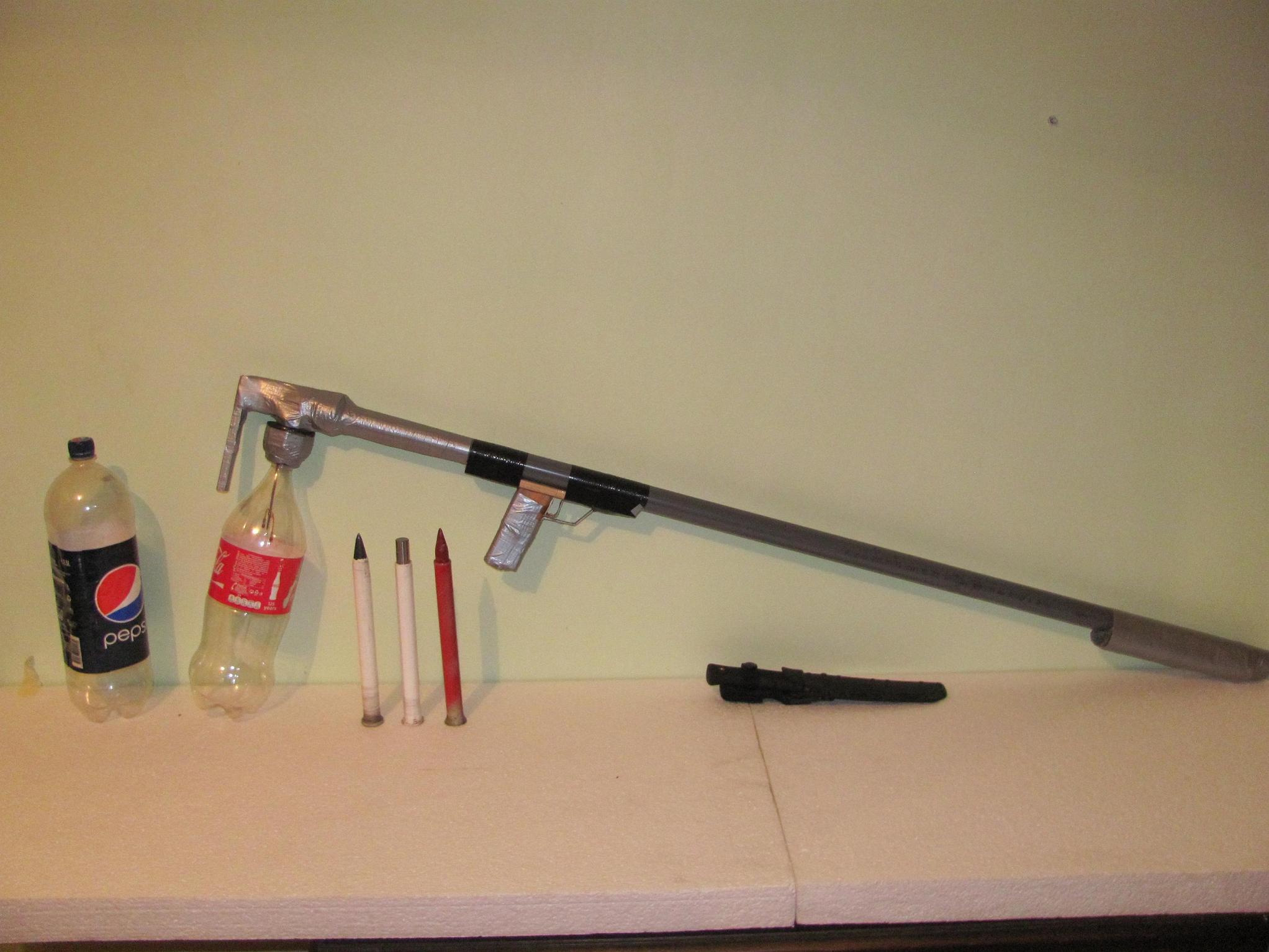

Here's my new special zombie survival spudgun. It fires 20mm polypropylene projectiles with a steel penetrator. The barrel is 28mm inner diameter so the projectiles are with a little increased diameter at the one end. The fuel is in pre-loaded 2l coke bottles(two under my bed and 3 over the wardrobe) and is H2:N2O 1:1 or Methanol and N2O. The ignition is with two professional pyrotechnic ignitors powered by two AA alkaline batteries. The trigger is two well sanded copper plates with a plastic safety witch goes to the one side to disengage. The barrel is ported. Allowing the pressure to drop before the projectile leaves the barrel makes every shot ridiculously accurate. The gases pass trough steel wool witch cools them and adds a little sound suppressing effect. It may look a little ghetto but I'm on a budget here
and the tape isn't holding anything critical. I couldn't make a video with it but here's a link with an equivelent gun (that one is a prototype with lighter piezo ignition, no glue used to hold the cut off bottle cap in the gun
but still no fail of anykind)

The trigger is taking ghetto to a whole new level

What sort of performance are you getting? If I recall correctly the old standard for anti-zombie effectiveness was penetration of 2.5 inches of pine board, and those planks you're shooting at seem pretty thick...

I trust my design more then I trust any button. About performance, I did a test. 6 layers of denim, 2 layers of rubber, one layer of 1/2" sticks, 4 layers of cardboard, few more layers left from testing of my knives. The steel penetrator went trough this and 1 inch in to the wood behind, and that's a pretty fat diameter. Now I'm thinking a way of making hollow point somehow.
